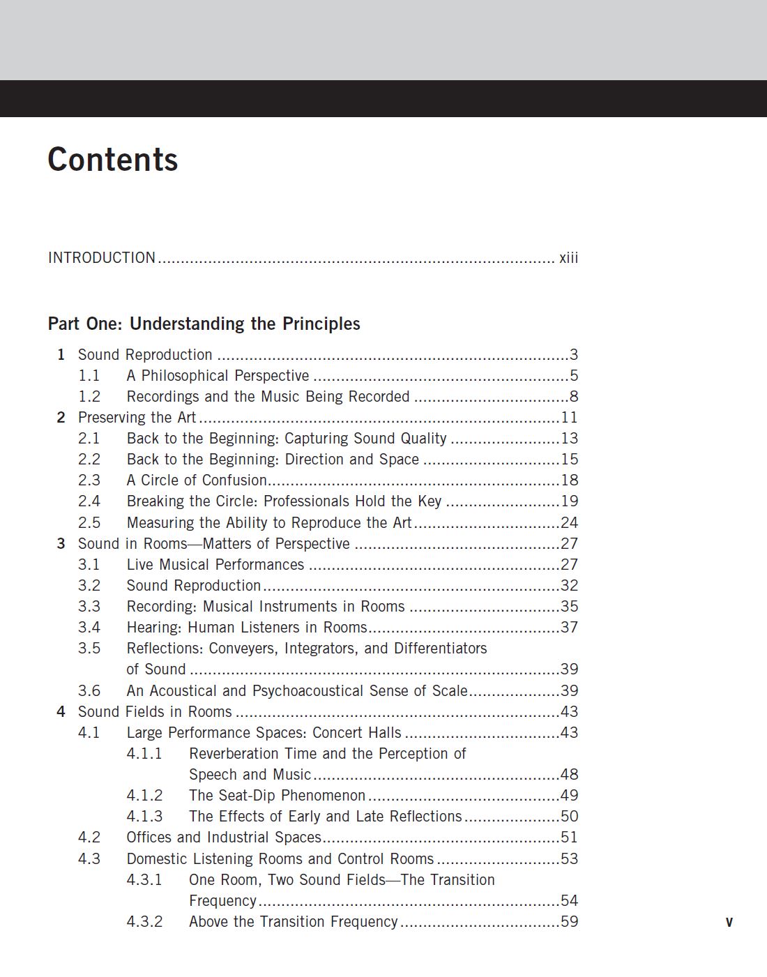

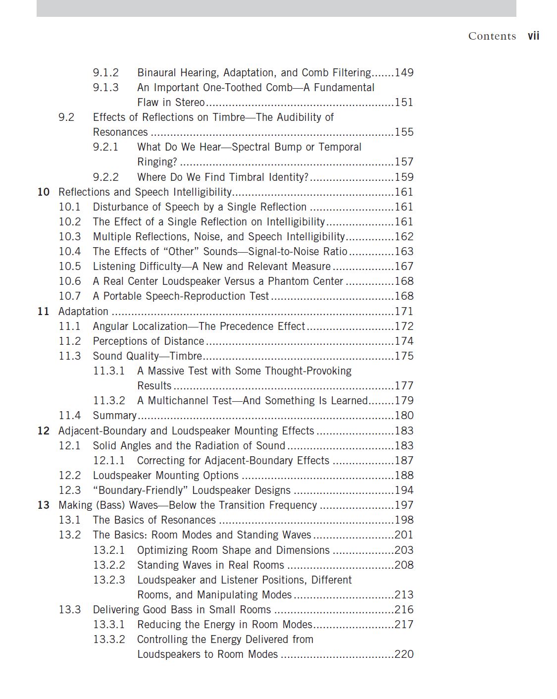

Apart from alpine and sport climbing, my hobby for the last 3 years has been understanding acoustics in a listening environment.
I went through some nice videos (including this video posted by @Simon-in-Suffolk) and very interesting/educative readings like some AES papers and handbooks like “The Handbook for Sound Engineers, 5th Ed.”
The following one is, I believe, a must read to anyone interested in music reproduction through speakers based systems.
After going through part one of the book, I concluded that the “source first” or “speakers first” credo is largely overrated…
“Room First” is a reality, largely underestimated… unless, of course, for headphones based systems.

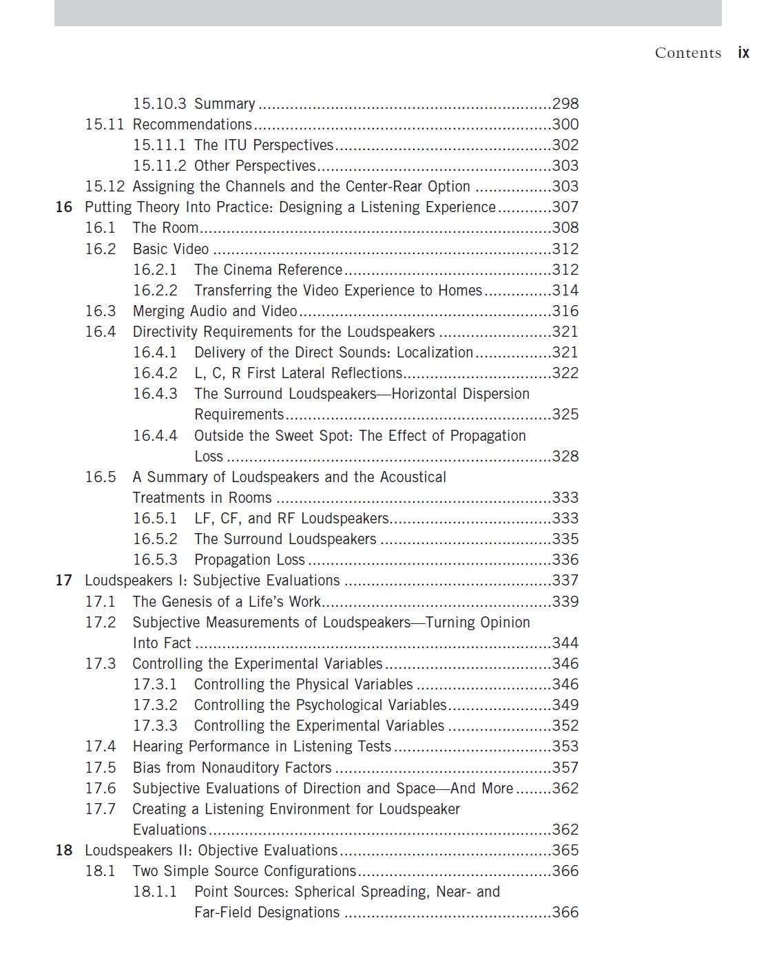

Table of contents:
Ordered on Amazon. Available as of 5 February -
Ordered one too. Should be interesting. Thanks for posting.

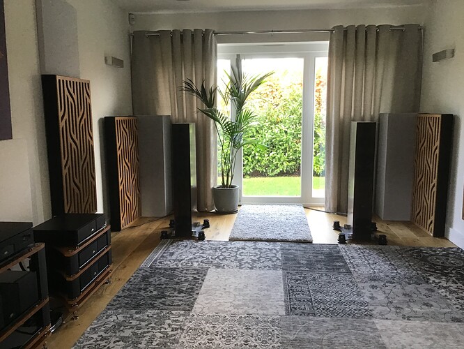

Couldn’t you just shut the curtains when listening? Wouldn’t that stop the second reflection on the glass?
Hi Yoman, well I was literally just mocking about at that stage trying all sorts to see what the effect they had.
This is what it looks like now. There is 100Hz tuned absorbers behind the curtains resting on the floor. I leave the curtains in that position permanently. ATB Peter
Reduce, likely above a particular frequency, probably mot stop. How much reduction and over what frequency range would depend greatly on the curtain material.

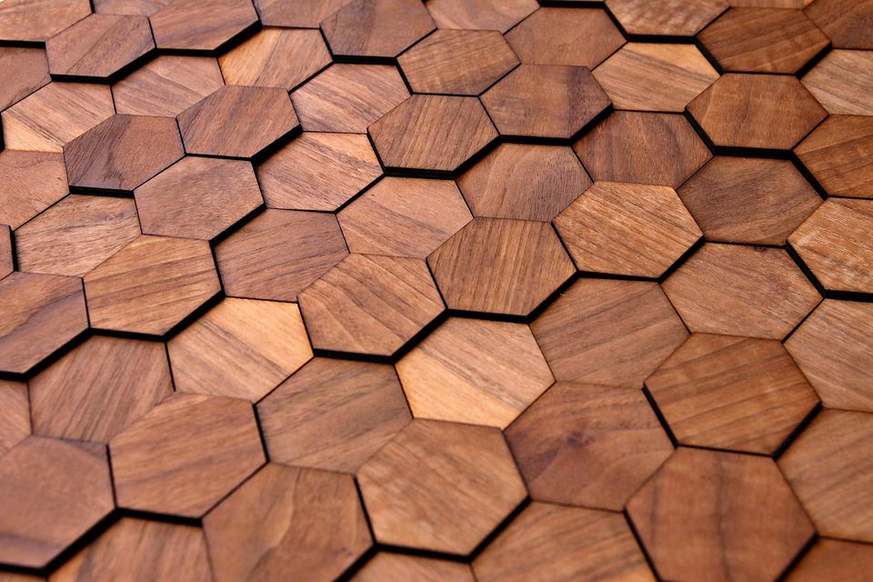

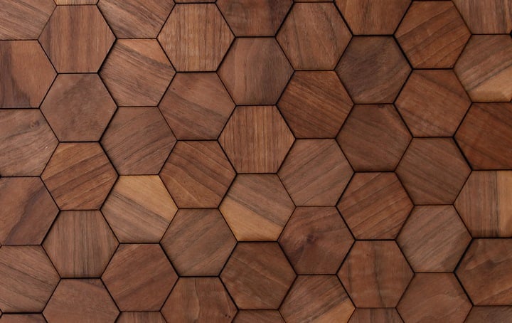

I came across this product earlier and thought it looked interesting and attractive, I realise after reading some of this thread that looks don’t mean anything when it comes to room acoustics and treatment.
They come in two sizes and each size comes in two thickness’s, I think somebody in the know could make a very interesting wall using multiple thickness’s.
Top 5 of all rooms on the forum
Rug is lovely
The whole room just works perfectly
I’m sure music sounds quite good as well
David

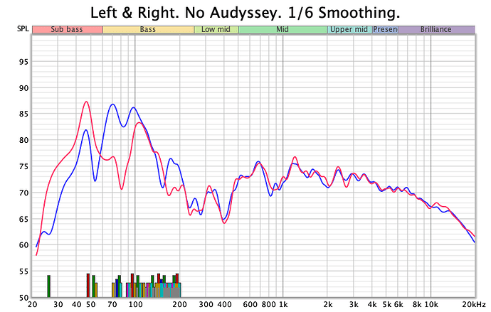

Reading this topic was a result of me doing some REW measurements and being a bit shocked by the results!
The dip between 200 and 500 hz looks like a problem? Bass peaks should be tameable?

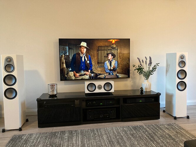

The room is 6.6m x 3.6m and 2.3m high and I’m listening widthwise. Wooden floor, 3 sofas, windows to the left and patio doors to the right, not much on the walls yet, tv between the speakers (so restricted on listening position) and centre speaker above the amp (on isolation foam but which I guessing is still a big no-no :grimacing:)
Any tips on where to start would be appreciated, meanwhile I have a load of videos to watch from this topic :slight_smile:

How may measurements did you take … you need to take a whole series…moving the mike a little each time…then average out…

Ah good point, I’m used to doing that for the AV side of things, didn’t occur to me to do the same for this. I’ll do the measurements again, been trying to sort out the speaker positioning first … and driving the family mad at the same time :wink:
