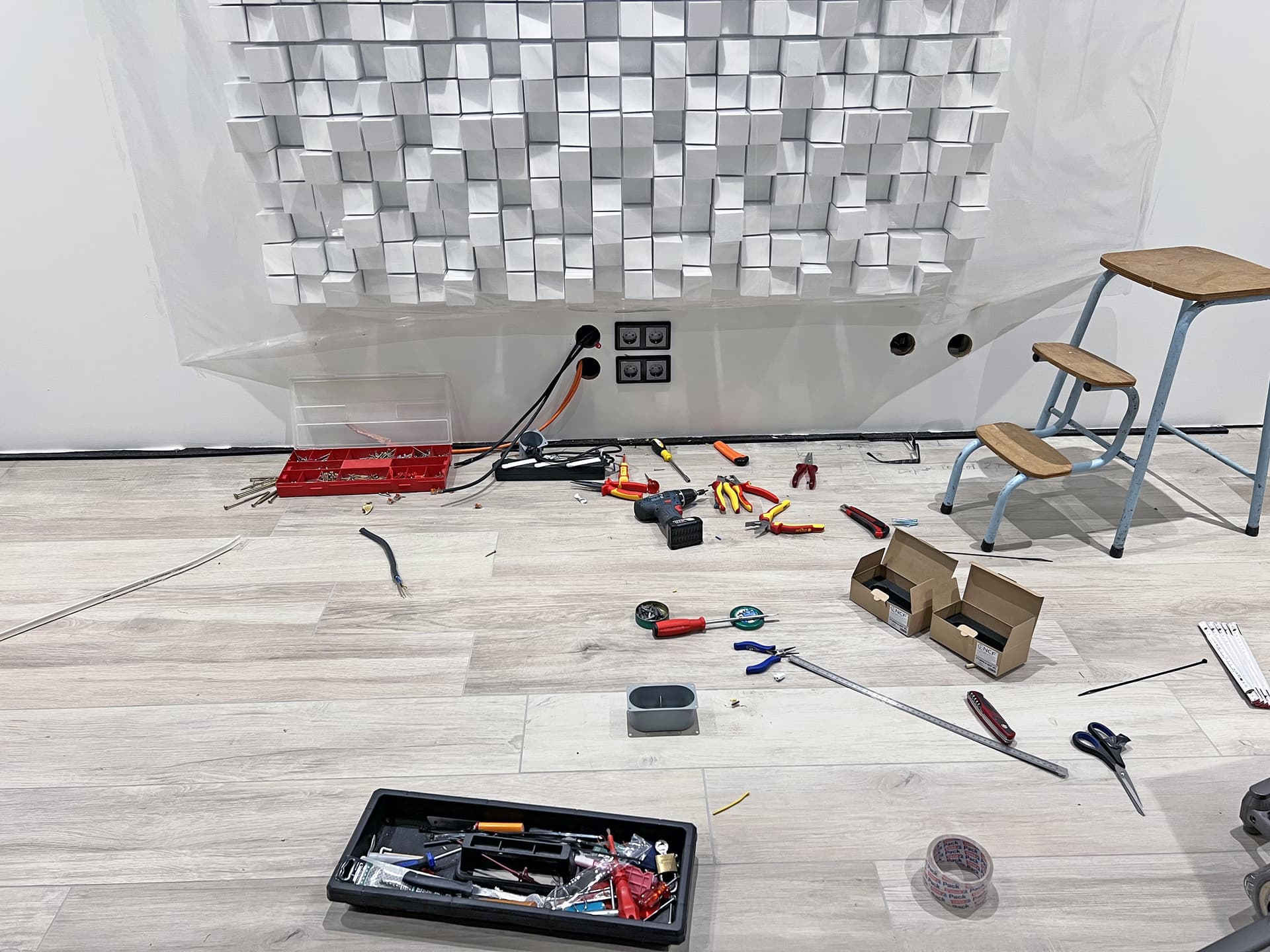

Believe it or not, but installing the 4 Furutech electrical outlets took me 5-6 hours of actual work! A full day with some breaks.
When you think it’s going to be quick and you get stuck in one mess after another… :face_with_spiral_eyes:

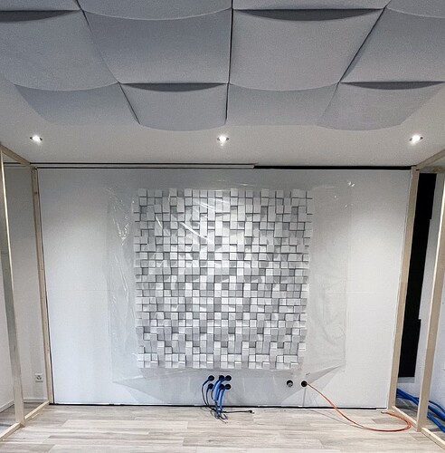

Tomorrow I’ll take care of the network sockets. Much easier… or not :sweat_smile:

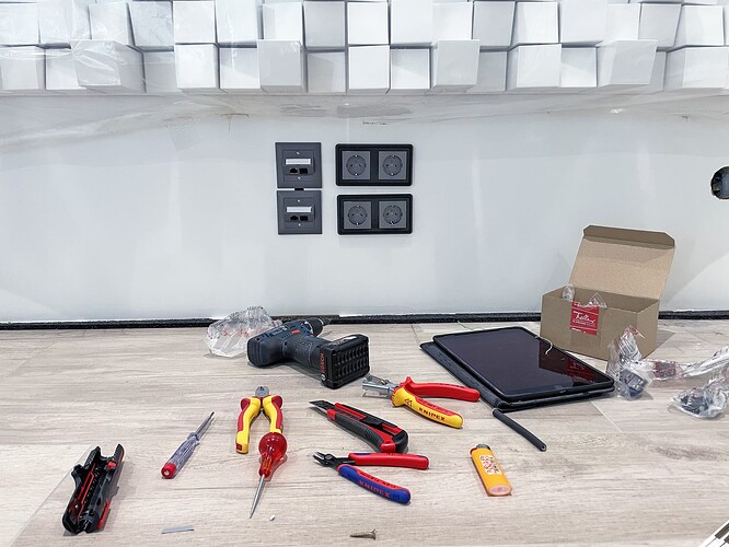

Nice, also a fan of PB Swiss & Knipex. Although I have the classic handles for the former.
That’s it. It took me less than 2 hours.
There are 4 network outlets.
For two types of ethernet cable.
  • Good quality industrial cable (R&M ca.7A S/FTP 4P AWG22-1300MHz)
  • VIABLUE™ EP-7 Silver Cat7 network cable
Each is terminated in two different ways:
  • shielding connected to both ends (network socket and switch)
  • shielding connected to the switch only.

It also allows me to play with two different types of network cable: the audiophile cable (Viablue) and the industrial cable (R&M).
The two top connectors are Viablue. Shielding terminated at both ends, and shielding terminated at the switch side only.
The bottom two connectors are R&M. Shielding terminated at both ends, and shielding terminated at the switch side only.
Makes sense… especially when it’s way easier to do it at this stage. Good idea to have a mix of shielded and unshielded options.
All cables are shielded.
I just didn’t connect the shielding to the RJ45 connector.
The connectors themselves are different. One is shielded and the other is not.
Sorry, that’s what I was meaning. I’ve a couple of shielded cables with one end floating (not connected to the RJ45).

The plug looks of level thomas or is it the photo.?
Having read Thomas posts i suspect i could calibrate my spirit level of those sockets!
Hi Thomas, would very much agree. I appreciate that I haven’t taken my room as far as yours, but even the 22 panels in my room has literally attenuated the boundary effects to a point ( not fully ) , where I feel that I am only hearing the sound from the system. It’s taken literally 2 years to finish and as you say, there is no going back for me either :blush: Keeping my fingers crossed for your project Best Peter
I have 1970’s stippled ceilings which I would love to get rid off. Thomas has made me think that I should save myself the cost even though all the reviews say that though there is an acoustic benefit with stippled (popcorn in the US) ceilings it is quite small!
Indeed, the top double socket is not quite level. It is tilted by perhaps 2-3 mm. This is a bit reinforced by the picture.
It’s a miracle that I managed to connect all that.
I’ll skip the details, but believe me, it was a real challenge…
Little space in the wall, the 4 huge GigaWatt cables placed in tubes, the flush boxes, etc… in short, I didn’t anticipate enough the location of these plugs.
I could have paid an electrician to do the job, but I’m glad I did it myself. I don’t think he would have had enough patience or attention to detail.

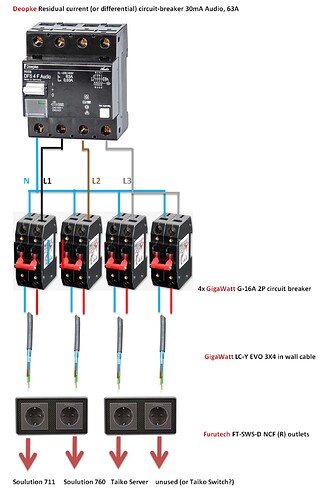

I paid the electrician to redo the breaker box and move some switches and outlets.
I am quite happy with the installation.
Each device will have its own separate live wire, circuit breaker and plug. I don’t think we could do much more.
