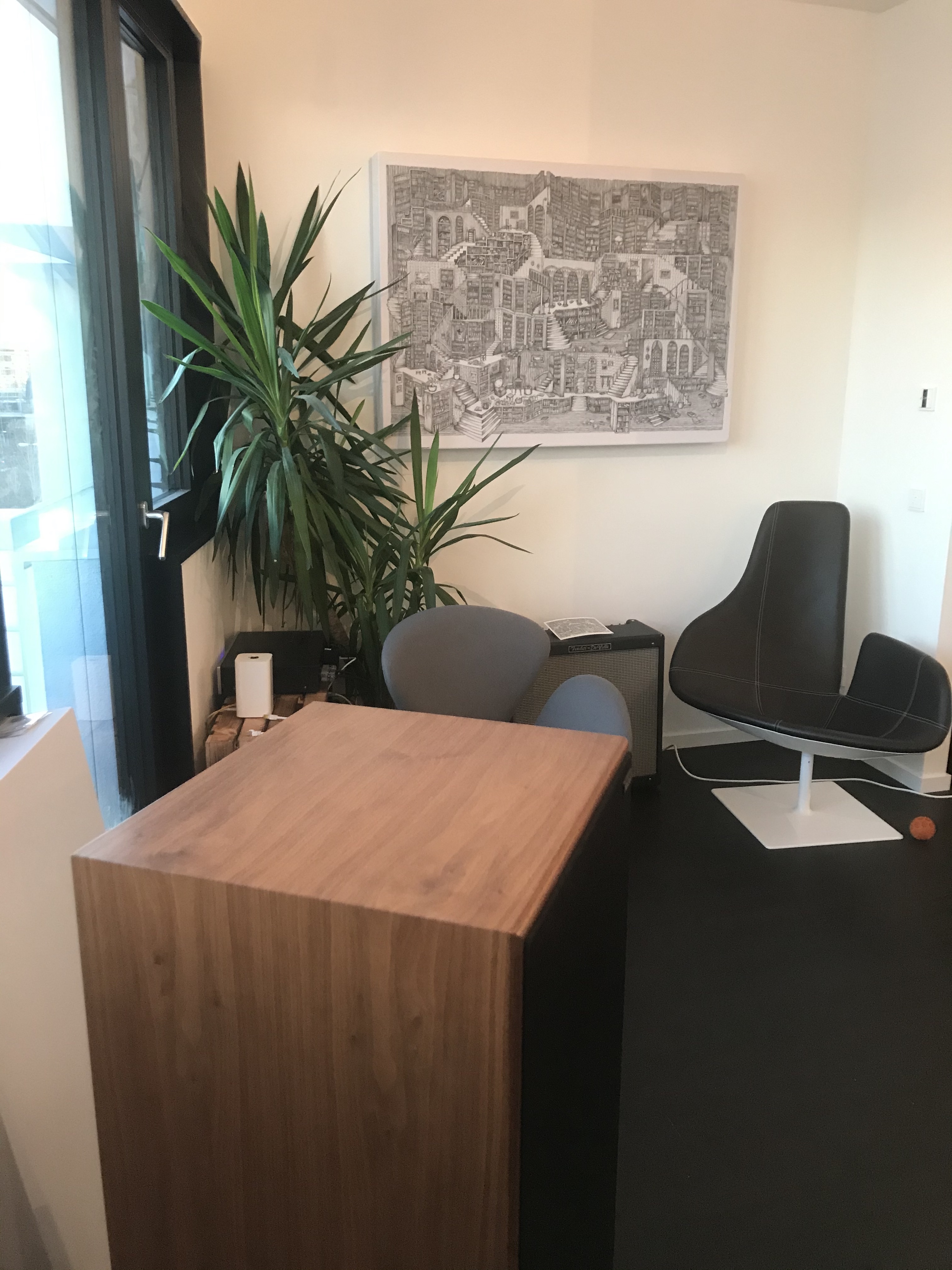

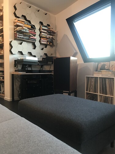

Very interesting thread! I watched this video some time ago and after I had already started to do some acoustic experiments myself. For now I focus on the first reflection points as well as furnishing. I moved into a new apartment 6 months ago and since then I have been trying out some stuff. I focus on broadband absorption with 10 cm thick panels. As for most of us I aim to find a balance between stuff that improves the sound but also does not make a negative impact on the feeling of the room itself.
Getting a new sofa in wool with an ottoman replacing a sofa table made a big and positive impact on both the visual feel of the room as well as the sound quality. The picture on the wall is a drawing by my girlfriend and is a custom ordered absorption panel, also 10 cm thick. She loves it and not only does it improve on the look and feel in the room but it also has a positive impact on the sound. A win win for everyone involved!
Interesting drawing - sort of MCEsher-ish, though without the optical illusion. Nice touch with the protrusions into the border.
Where did you get your traps?
