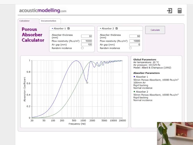

Just dragging this old chestnut up. For equally afflicted I just thought this is an interesting video by Jesco. ATB Peter
Peter, it seems as though the video is suggesting that a 12 inch thick bass trap comprised entirely of rockwool would perform similarly to one made of 6 inches of Rockwool with a 6 inch air gap behind. This seems illogical, but he seems to have graphs supporting this. But for most people, the real constraint is space rather than the cost of Rockwool so it doesn’t actually get as much further forward unfortunately.
Hi John, having just watched the video again I agree with you entirely. This principle can of course only be ‘stretched’ so far to avoid, what Jesco displays here. You shift the efficiency of the panel towards an even lower frequency, but start getting a drop further up. This could be somewhat tuned depending on your target frequency in your room:

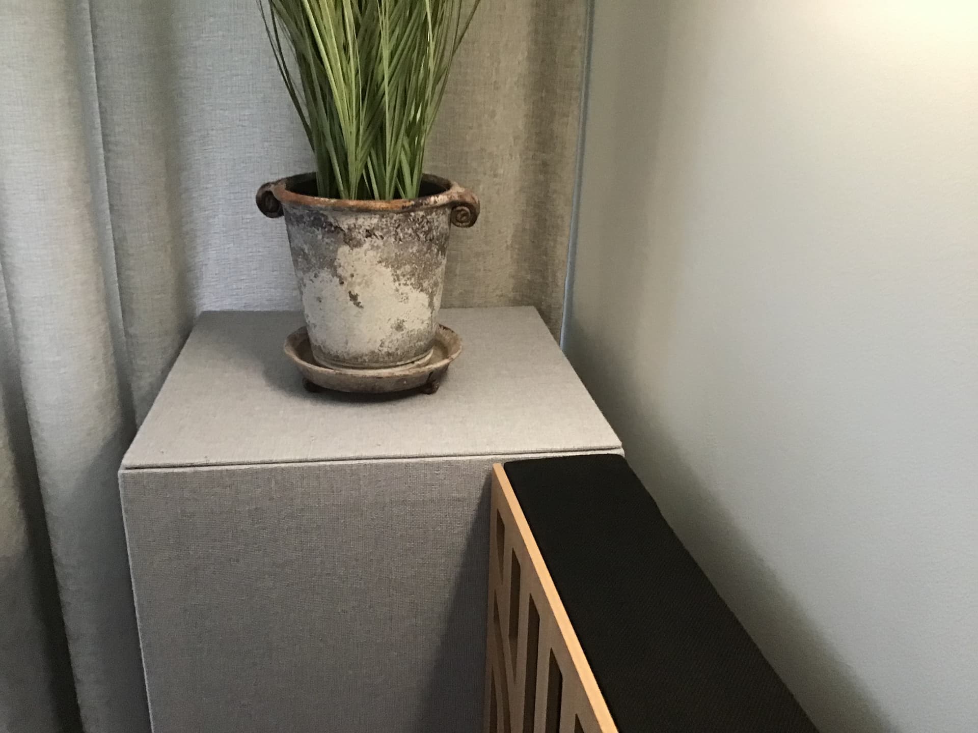

As displayed on his graph above. Jesco bear in mind specialises in home studio treatment, ie where less consideration aesthetically need to be applied compared to more domestic environments. In my case having used GIK soffit bass traps (42x42x115 centimetres) in the speaker end corners, it would be look rather odd and hopelessly intrusive moving them a 1 1/2 foot away from the corners :face_with_head_bandage:

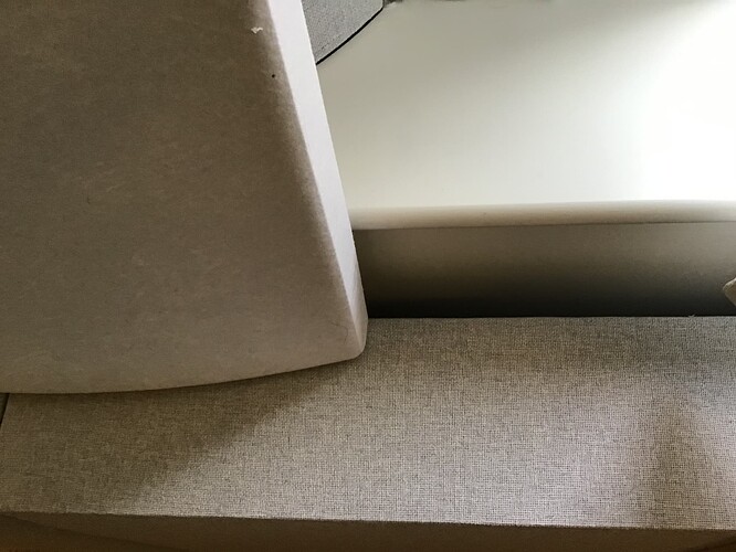

I settled for a 2 inch air gap as seen below:

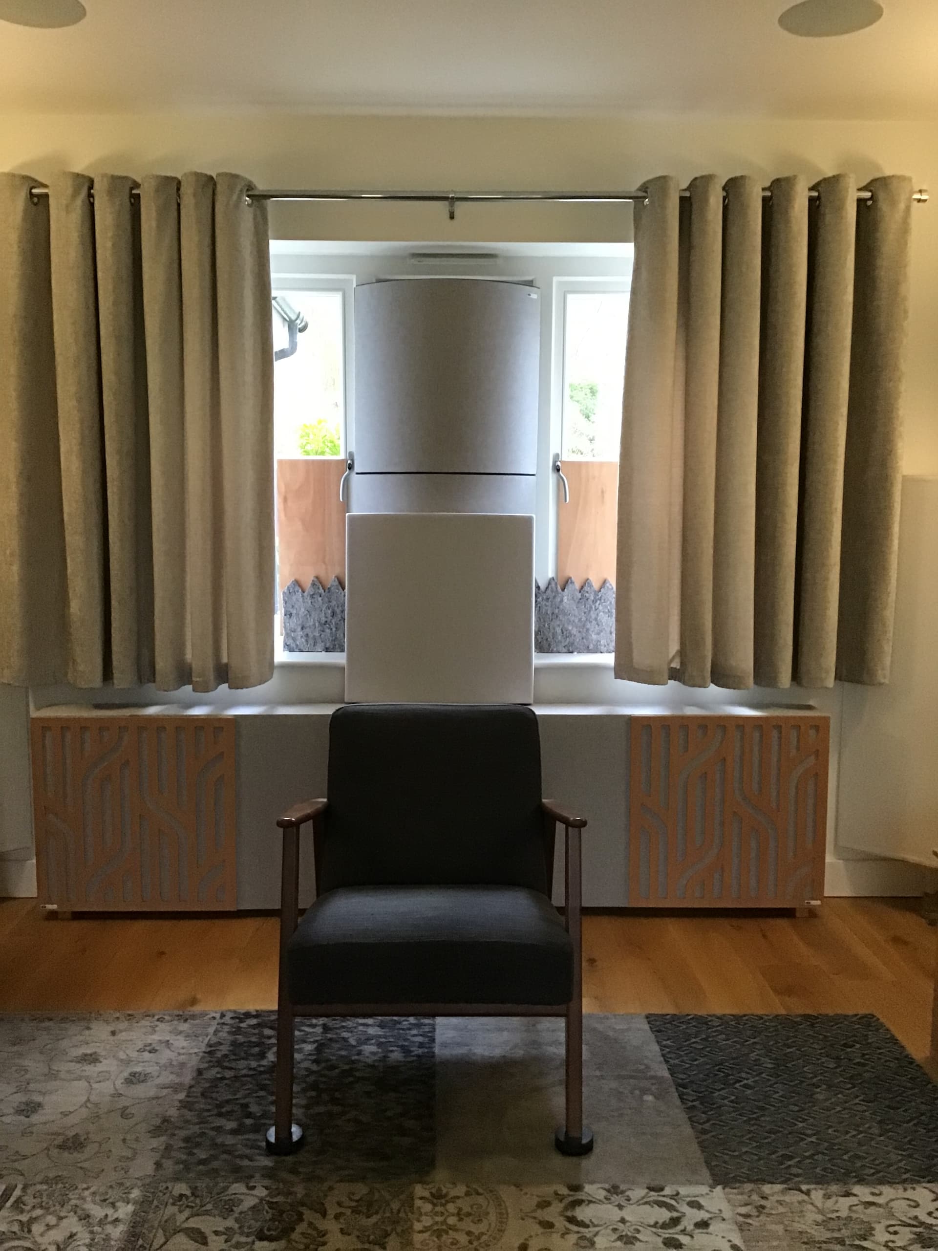

Behind the listening chair I left a slightly smaller gap between the rear wall and my monster bass traps:
The 10 mm plywood sheets on the window ledge covering 1st reflections from the window panes are painted black on the other side with water based paint to leave them discreet looking from our drive outside.
