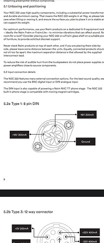

Yes, the 8 pin DIN connector on the 222 carries power
And in fact the NVC TT is clearly mentioned in the manual page screenshot ^^
Yes, XPS powers the entire NSC 222. The mains plug in the back of the NSC 222 is removed.

Yes, NVC can be directly plugged in to 222 and 222 powers the NVC too
