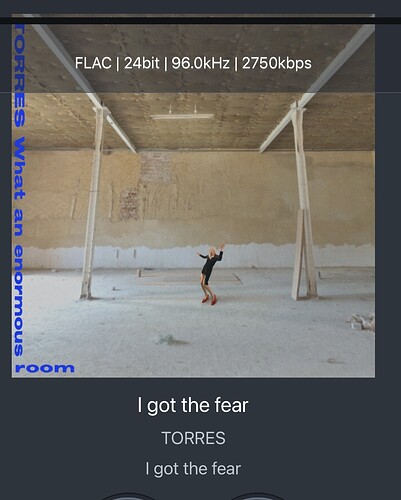

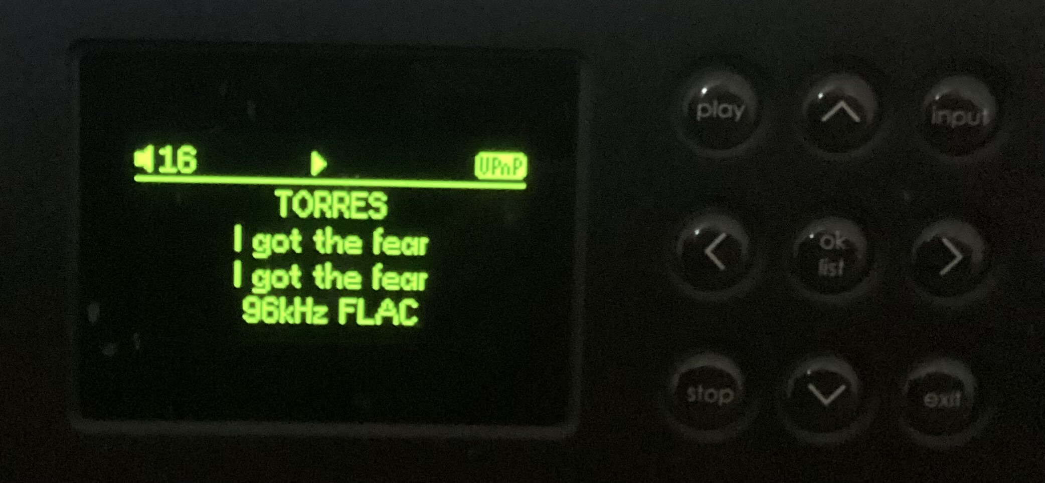

We were using an SMSL PO100 Pro to do this into SuperUniti via SPDIF originally.
However, software/apps have caught up and apps like mconnect can now do the job, We also use this with NDX2.
Hopefully at some point in 2024 naim can make Tidal Max available via firmware but given app workarounds are available it’s not critical. (Most manufacturers/competitors had this available by Jan 2024 so naim are already 3 months late with delivery).

Hi,
I have downloaded the mconnect app and tried a few tracks.None playing in the max format.Could you please explain the set up procedure to get the hi res files to play on ndx1.
