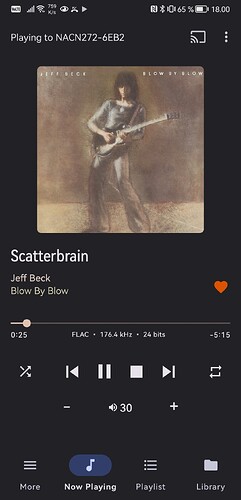

Bubbleupnp on my android plays Tidal on Nac-N272. Is that the resolution I’m listening to, Flac 176.4/24..? As you know I can usually only stream 16/44 over my Nac272.
After playing from Bubbleupnp, I then played with my normal Tidal streaming 16/44 from my Nac and I don’t think I can hear any difference.. Maybe I should give it more time in listening
