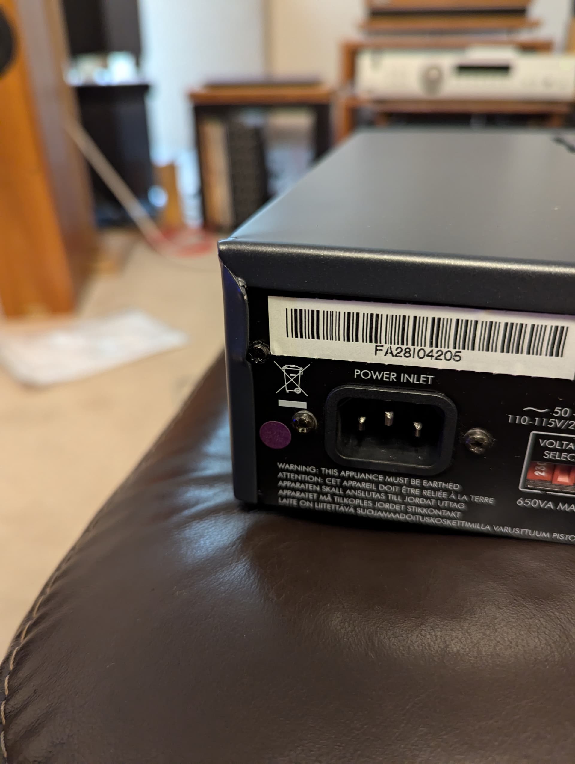

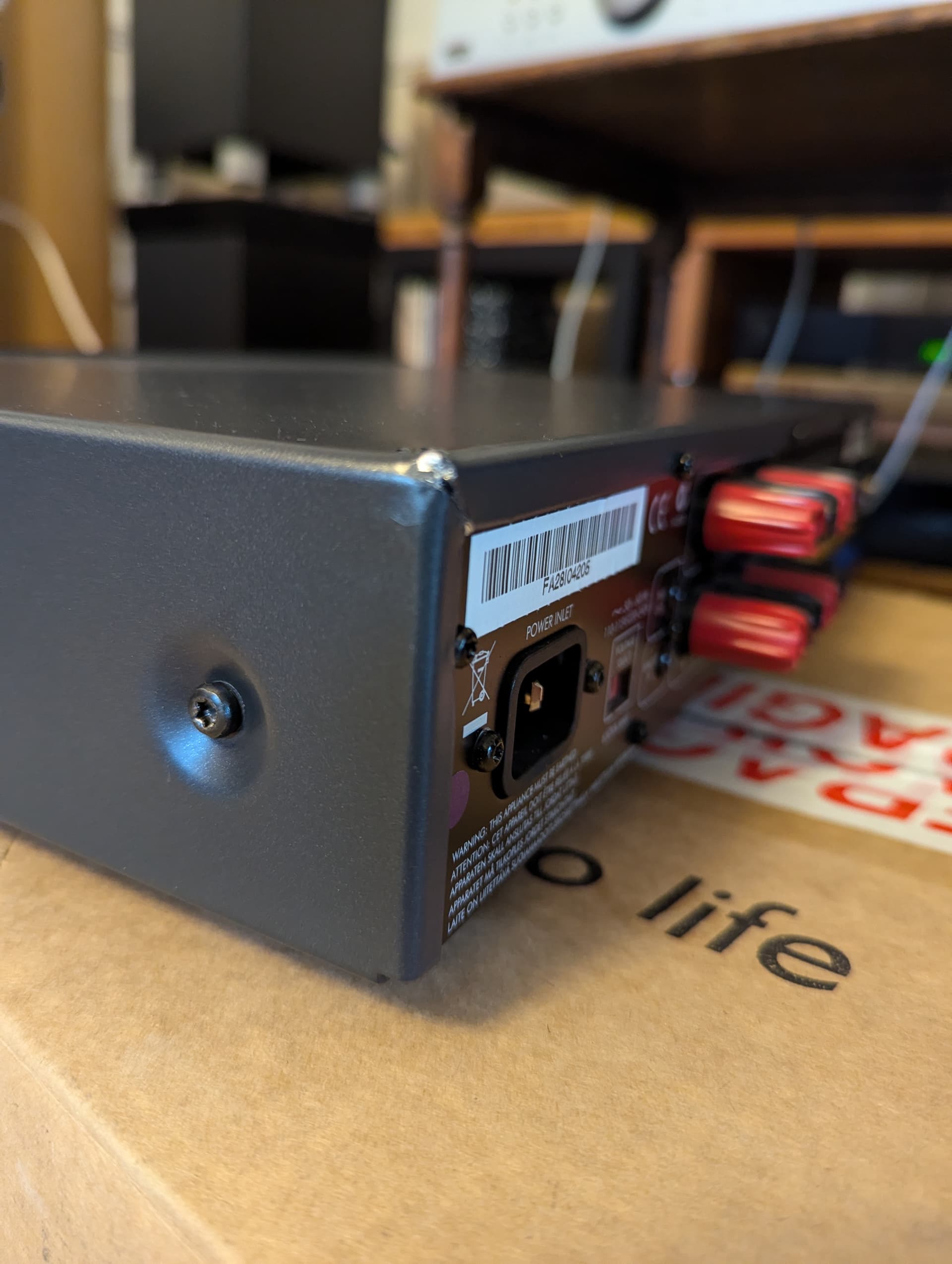

And this is the damage it sustained.
I’ve managed to straighten it about 80% (got the dent out at the side) but some of the paint has flaked off a bit.
Send the photo to Noratel and see what they come back with.
What caused the damage. A Black marker pen should hopefully hide that, given it’s at the rear.

I don’t know - all four corners are encased by foam when in the box - I discovered this a couple of days ago when I unboxed it. I’ll try a marker pen - good idea.
