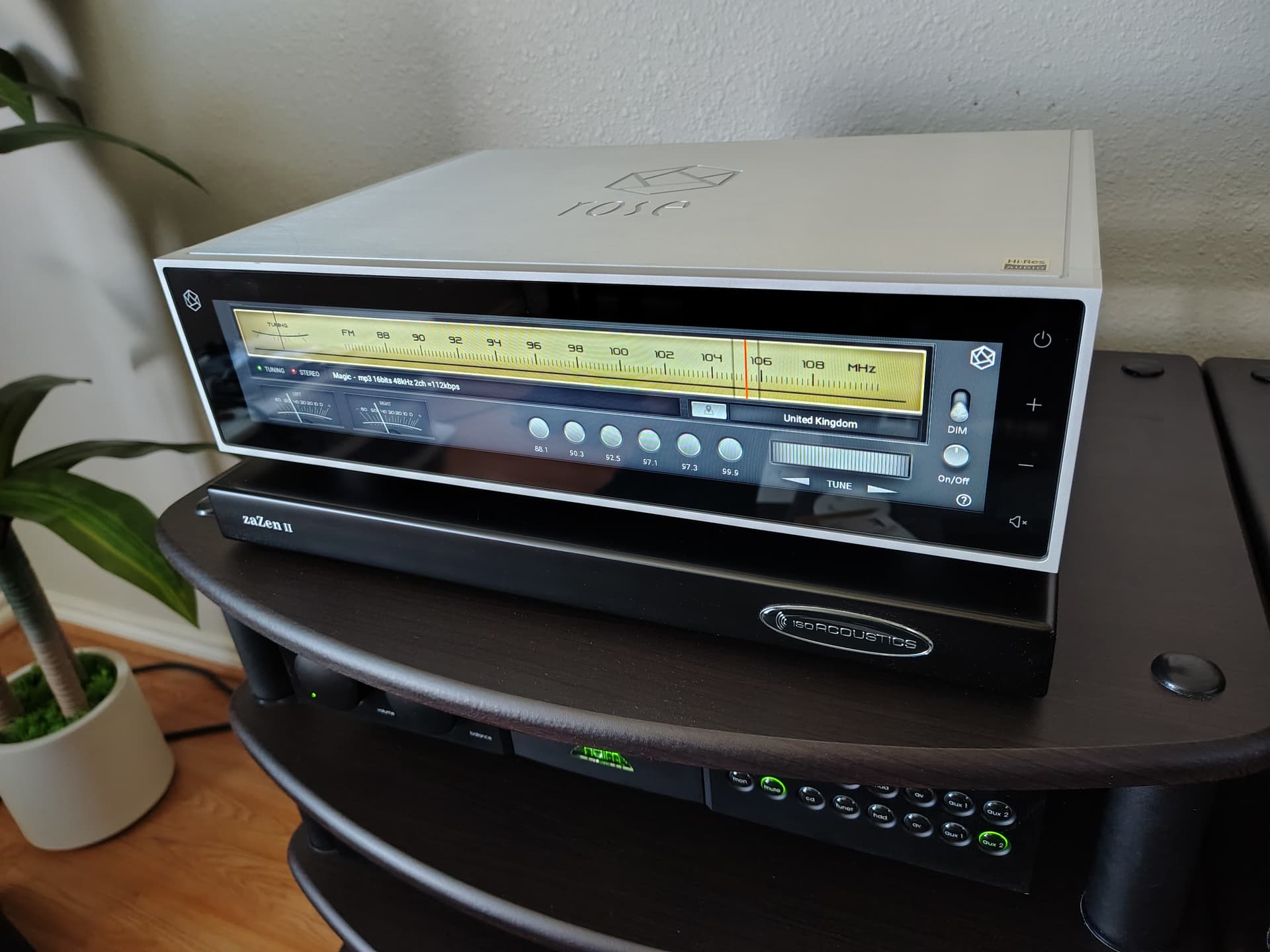

You need something like this!

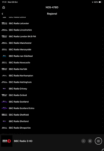

Newcastle available on Naim Radio

I’ll have to check that out but if so that will make things easier- cheers
Cheers- problem is that they cover both Sunderland and Newcastle. You have to switch between fm or dab depending on who is playing at home. So don’t know if internet radio would cover both or just whoever is away that week. I’ll check it out though- cheers
