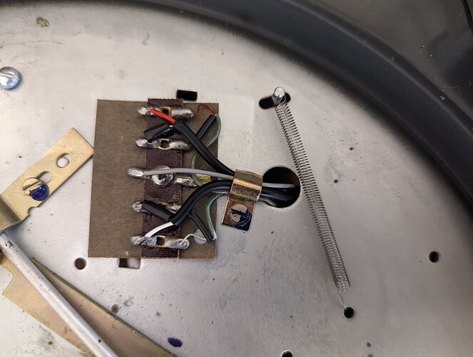

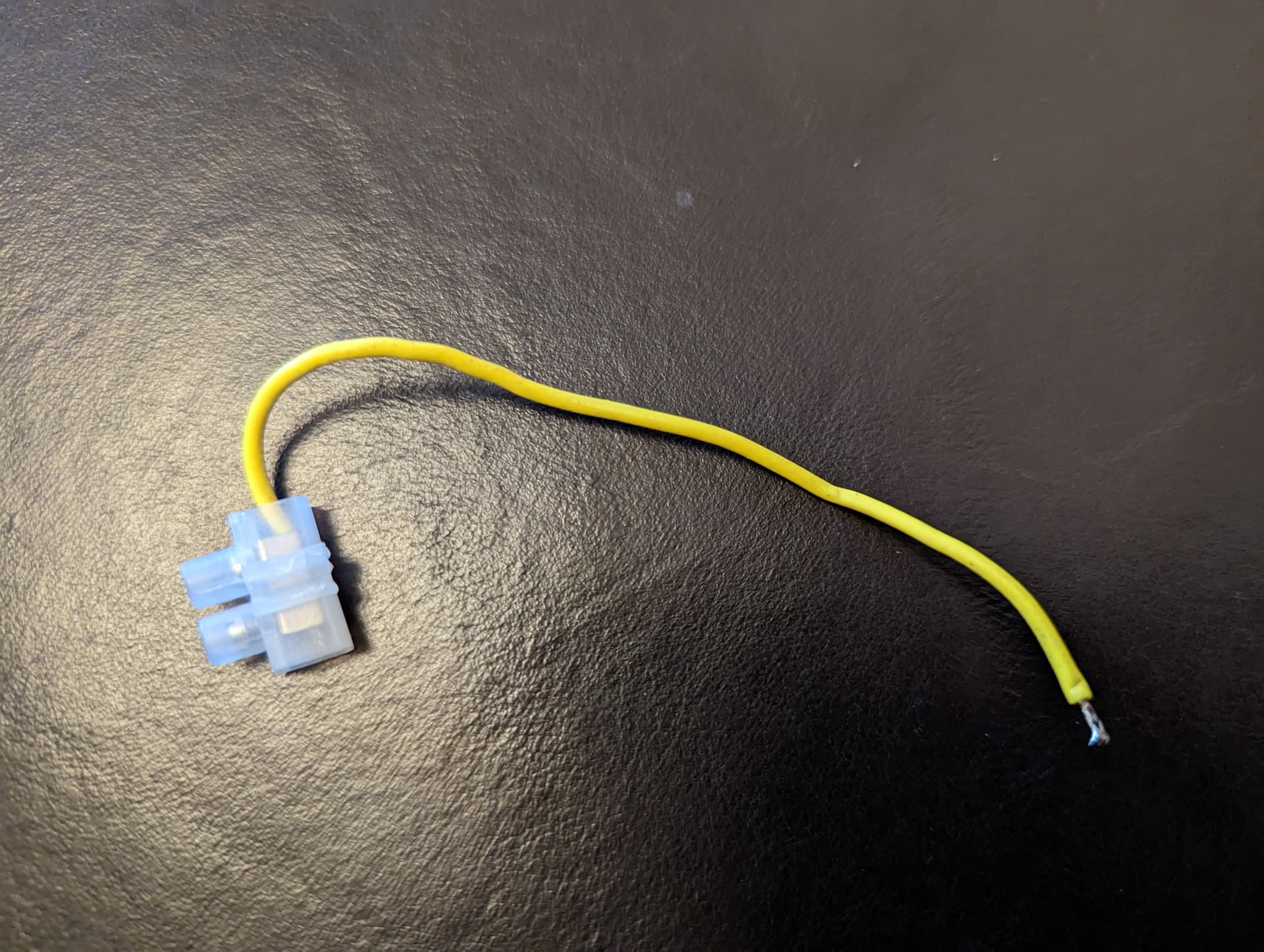

I have attached pictures of the ‘terminal block’ under the platter: the grey wire in the middle replaced the yellow ‘arm ground’ that was definitely in place before it went to them - I managed to dislodge the arm end of the yellow wire before I sent it to them so I definitely know what it was for.
They returned the original yellow wire (pictured) and also the original arm/cart signal wire that was removed when they swapped the 5 pin din to dual RCA + ground wires.
From what I can tell things are as they should be. In their correspondence they did mention that the motor sometimes ‘buzzed’ during soak testing but I’m not sure how this would manifest itself through the speakers as a ground loop hum?
