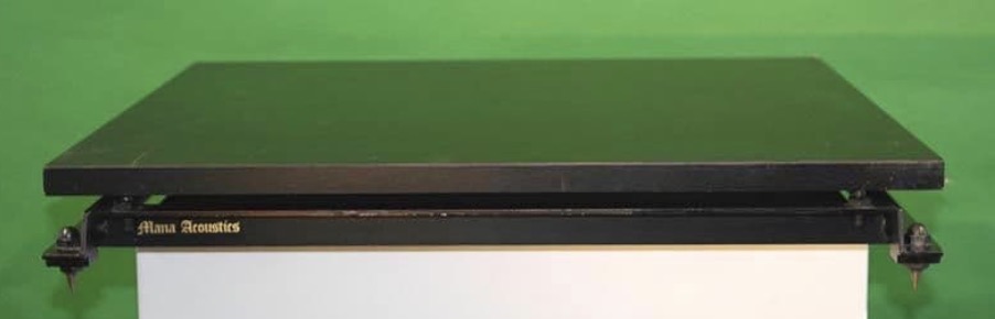

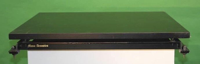

Not much advice except try things and see how they sound. I think the main problem will be coupling the LP12 to something that has high mass like a sideboard. As the Sound Organisation proved, way back in the 80’s, low mass tables are the way to go. I’d try something like the Mana tables, the small base ones not the big ones. A couple might be good with the board on the bottom and glass on the next one. It’ll be a trial and error thing but at least you have a good baseline to compare it with. If you have Linn’s suspension base board it would help but if you are using standard rubber feet the LP12 will be very sensitive to placement.

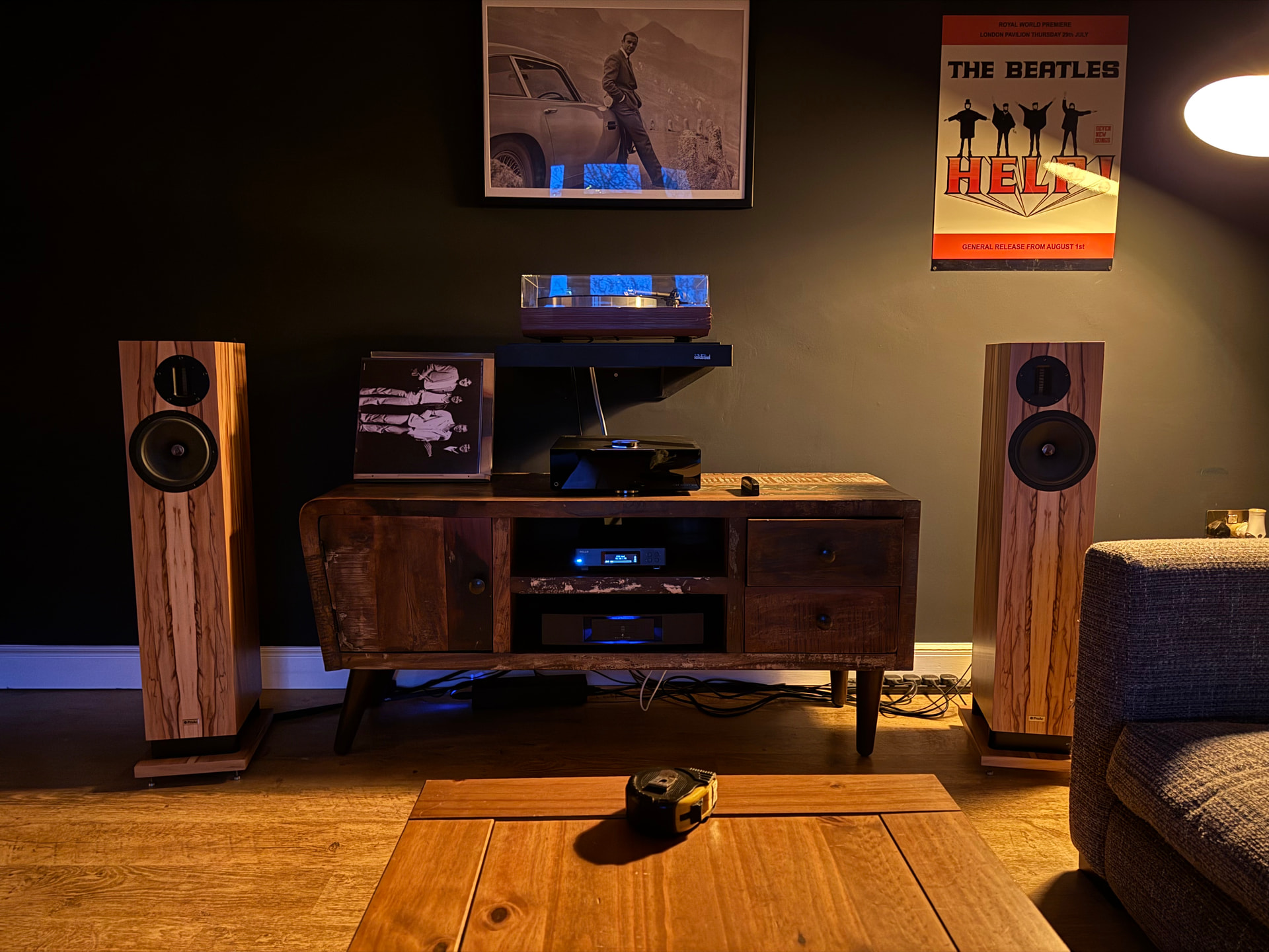

So much depends on the media unit. Can you move the shelf so that it hovers just above the unit? Are there other compromises that can be reached? Maybe post a picture so we can give you some ideas.

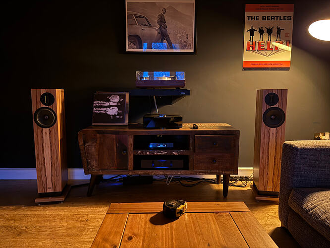

This is my system at the moment. I’m trying to remember exactly how much timber I installed behind the plasterboard to relocate the shelf to the right and down

That looks very nice indeed, though I see what she means, as the Linn is a bit stuck in the air. I’d move heaven and earth to get it lower, so that it sits just above the unit. I certainly wouldn’t put it on the unit, as it won’t sound anything like as good, no matter what isolation shelf you put it on. Get some Gyproc Easifill to sort the holes, a touch of paint and you’ll never know where it was previously.
If you have a timber floor, I wouldn’t even consider sitting it on a sideboard / unit.
In my experience, the record deck always skips if someone walks past if it’s sitting on anything on a timber floor.
