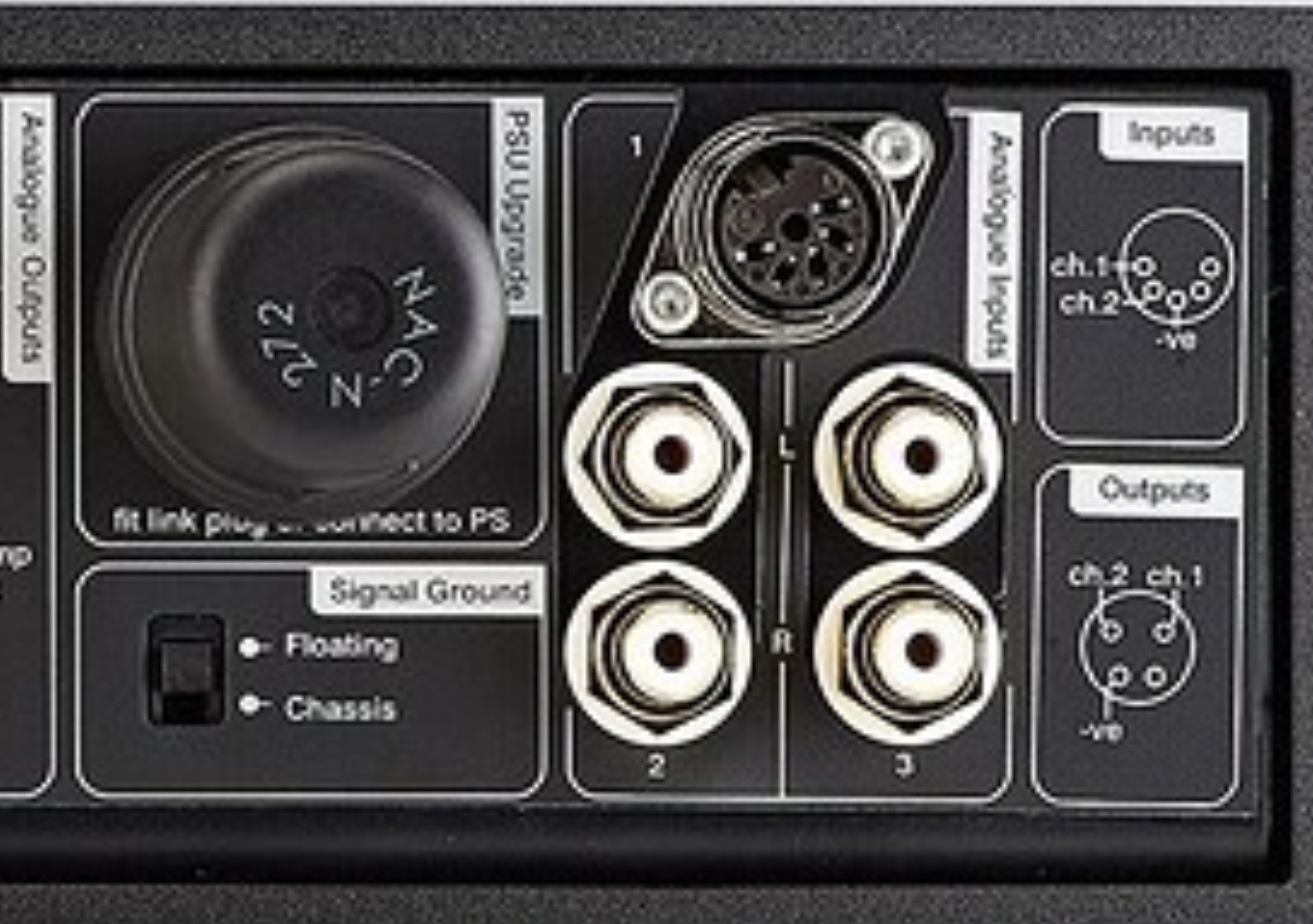

What input do you have the TT connected to. Input 1 is the DIN5 socket. 2 and 3 are the RCA inputs.

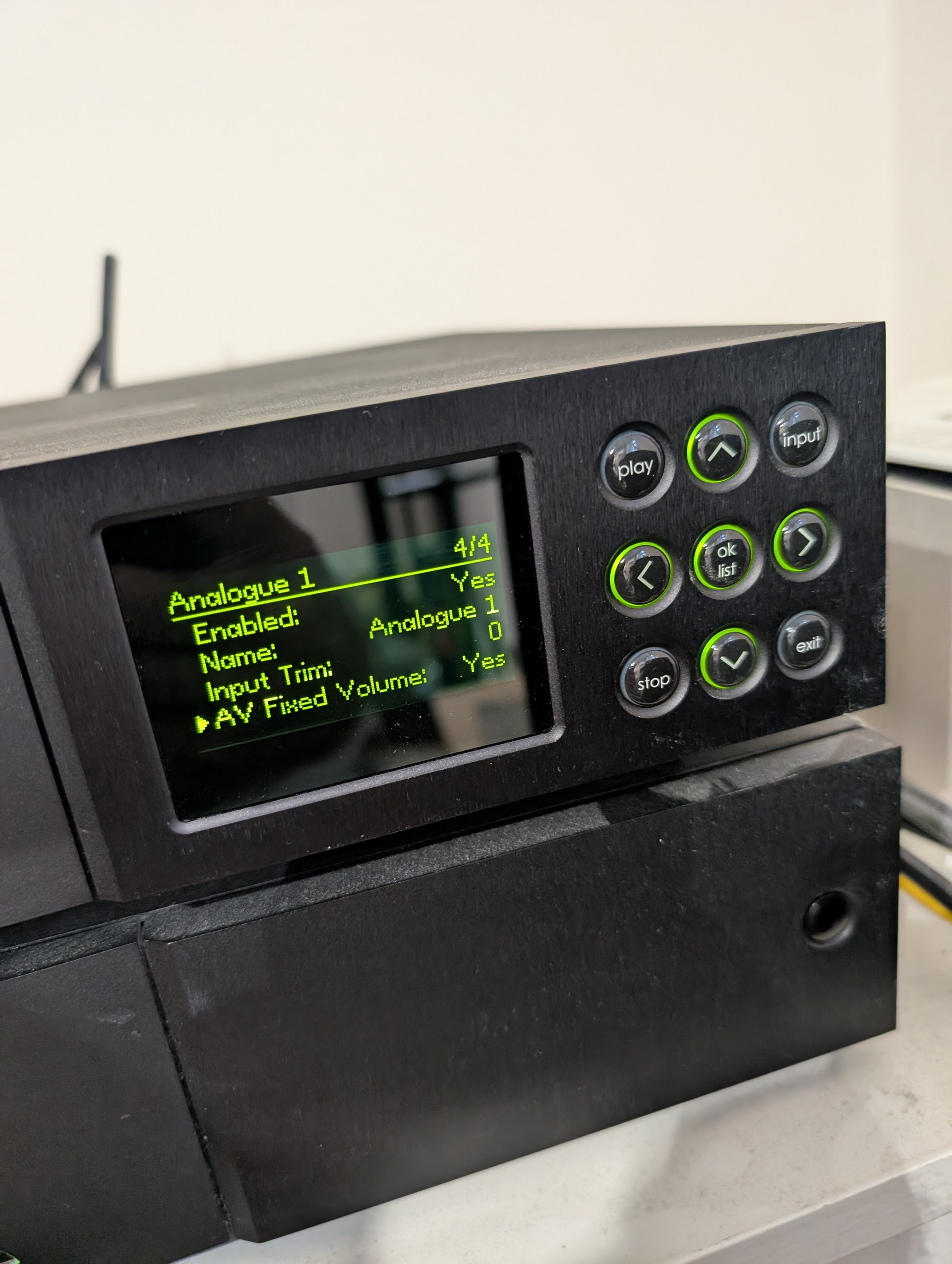

Not familiar with 272 but if ‘AV Fixed Volume: Yes’ does what I think it does that will be very loud…

You need to make sure the input the TT is connected to (2 or 3) is enabled.

You could try increasing the input trim.
It’s not unusual for a turntable to have a lower level input than digital sources, and a lot will depend on the cartridge and phono amp you are using. As HH says above, input trim adjustment on the 272 input you are using can help.

I don’t quite have earth sorted yet. as I am working to get a connection on the NAC-N and yes I saw to use the red RCA but that doesn’t seem easy since the spade terminal doesn’t seem to work with the plug . I am hoping to work out what the screws are on a couple of not in use sockets. but don’t seem to have the right driver size, I think it is small torx, does that make sense please?

I really wouldn’t be undoing ANY screws on the back of your 272……. you have no idea what they’re fastened to on the inside, might even be something important :scream:.

Input trim has indeed made the difference I was hoping to achieve. Thanks @HungryHalibut now at 3
