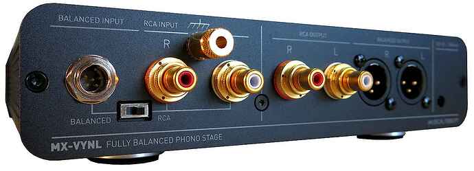

I’m using my old Pro-Ject Connect it CC cable in between the Thorens and Music Fidelity MX Vinyl phono stage, and a Chord Anthem 2 from stage to amp. My question is would a upgrade of the Connect it CC cable be worth while and is the option of a balanced cable which can be used with this TT and stage possibly a better choice.
I would say a balanced cable should bring better results.
But to fully exploit it you really want the balanced content to continue to amplifier, and that also needs to be a true balanced unit.

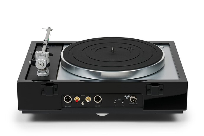

But I still have a great fondness for the Thorens that got me started. It seems from your photo that the TD160 has been pretty substantially upgraded in all that time too - mine didn’t have all those ‘bits’ at the back. And is that a Thorens tonearm in the photo, or is that from an independent supplier?
The Thorens TD 1600 is really a redesigned turntable, for a start the sub platter doesn’t hang from three springs but sits on them. The tone arm is a Thorens TP92, comes with the TT. Without starting a war, from what I’ve read it is a match for a LP12 for slightly less money. Not many making this type of turntable now days.
As for the balanced output I can’t continue to my amp as it doesn’t have balanced connections, and it looks like finding a cable to fit will be a big ask.
