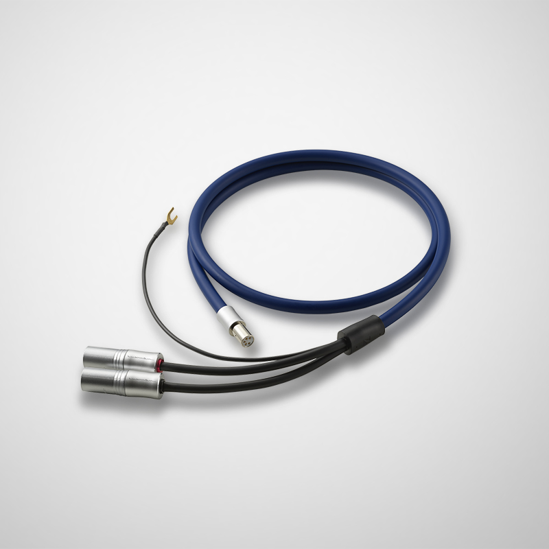

It’s worth a bit of reading up on that, as I wasn’t sure about it either. From what I can tell a cartridge, particularly MC for some reason, is an inherently balanced source. So even if the other decks offering XLR balanced out might have some electronics on board, it doesn’t make your existing deck not balanced.
Only issue if you ran a MM cartridge with long interconnects would be the capacitance of them. But I think you’re running MC? For the price of a set of balanced phono leads it might be worth an experiment with your existing deck?

I have been doing some more reading. And the xlr mc cartridge interface does give me options

Something like this connected to your LP12 might work…
