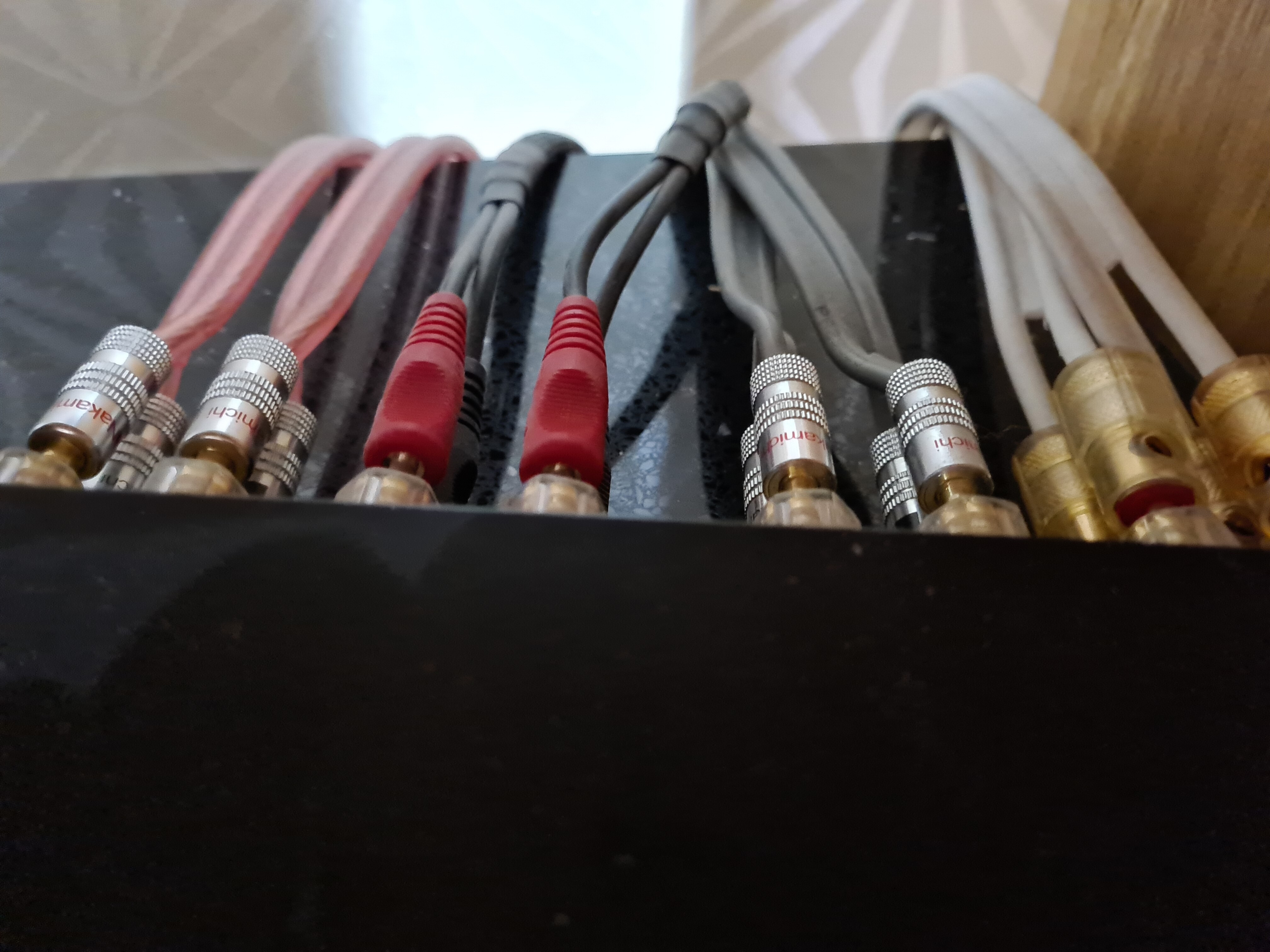

this is the back.

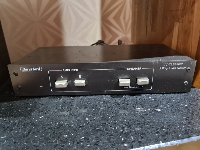

I use a Beresford TC7220 Mk II. I have an AV amp and my Nap135s attached, with the speaker cables going to the switch. Then two sets of speakers one set in the main listening room and another set going to the conservatory.
I have had this set up for around 4 years and have had no problems and there is no degradation of sound.

However, that appears to be academic: the pic you posted of the terminals only has connections for one pair of speaker cables if two amps are connected (or you could presumably wire the other way and connect one amp to switch between two pairs speakers)
Speaker cables are Symphony 400 from AV amp into Amp A switch.
Witchhat N2 to switch from Nap135s into Amp B switch.
Linn K20 from switch to conservatory speakers (speaker 1)
NACA5 from switch to main listening room (speaker 2)
Been using this for years now. No degradation in sound and not one problem. SImple solution to people wanting two amps with one speaker
And two amps with ability to switch speakers between two rooms!
The K20 with nakamichi banana plugs. Works for 2nd room absolutely fine. Quite a long run from my switch so when I did it I wanted to save some cash on speaker cable!
