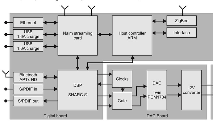

So, to clarify. A Core connected to the Ethernet input on a ND555 has the signal routed through this NP800 board then to the DAC, but if the Core is connected to the BNC input, the signal bypasses the NP800 board and goes direct to the DAC. Is that correct? In which case, using the BNC input would avoid sound changes associated with the firmware?

No you are not quite correct.
The NP800 network protocol module is only used for Ethernet, WLAN and USB applications as you say, but it’s separate from the main digital streaming engine… it is separated by LVDS to help with electrical noise isolation, and is treated like one of the digital inputs into the streamer… essentially it’s a custom designed protocol bridge.
The core part of the streamer engine, the digital streamer board processes and controls the different digital signal feeds into the Streamer, whether they be from the NP800, SPDIF coax, Toslink, Bluetooth etc.
It is this digital streamer board that is controlled by the ARM CPU. It is this CPU that is ā€˜tunedā€, if required, in software updates. This board undertakes the master clock management, as well as the digital audio signal processing… and conditions the signal for analogue conversion, or digital output by converting to SPDIF.
Therefore this software controls all streamer inputs, such as SPDIF, the NP800 network inputs etc… and any consequently software tuning affects the entire streamer operation and all inputs.
This also means software updates can equally affect digital audio and analogue audio outputs, and indeed I can attest to this.
Exactly, the Nd555 is used only as a dac. But you can’t have Qobuz neither Tidal. The Core streams his local files.
So, this means that any input going directly to the DAC via SPDIF will still be affected by the tuning Naim do the ND555. Listening to rips from my Core or streaming music via my Node can all be influenced or coloured by the firmware/tuning?
Nothing goes directly to DAC as Simon has said.
All goes through digital board/DSP before DAC.
And hence all sources influenced by FW changes.

Hmm, rather blows the theory of those using different digital transport as a firmware work around then. Though all those double ended arrows makes the signal path somewhat confusing. Not entirely clear that the digital inputs go to the ARM?
Interesting, so that means that you can’t effectively ever use the ND as a true stand alone DAC without the influence of the firmware/tuning. I didn’t realise that. I’m starting to see the benefit, a few have mentioned on here, of separating streaming and the the DAC components.
Thank you @Simon-in-Suffolk for your infinite patience with the layman.
With the aid of your explaination and the block diagram posted on the ā€˜Happy’ thread, I believe I now have a rudimentary understanding of the signal paths and processing of sound shaping within the ND555 architecture. Thank you!

The DSP is not linked always with the dac ?
Maybe the main difference between each firmware is how the dsp interacts with the streaming board ?
yes
In Naim designs yes the SHARC DSP is always linked with the DAC and digital audio output, the SHARC does many functions, it’ s an advanced device controlled the by the ARM CPU controller and the master clock and in many ways is the heart of the streamer. When the streamer is analogue audio mode the DSP chip (SHARC) also undertakes the oversampling and low pass reconstruction filtering function, as Naim disable the oversampling and filtering functions embedded in the DAC chips, such as the PCM1704K -as I assume they prefer their own implementation performance and is more flexible. When the streamer is in digital audio mode, the SHARC creates the new and sometimes modified SPDIF signals to be send to the Digital output.
The oversampling and low pass filtering using an IIR based filter has been unchanged since the days of the NDAC, though faster and better SHARC processors have been introduced through the years.
