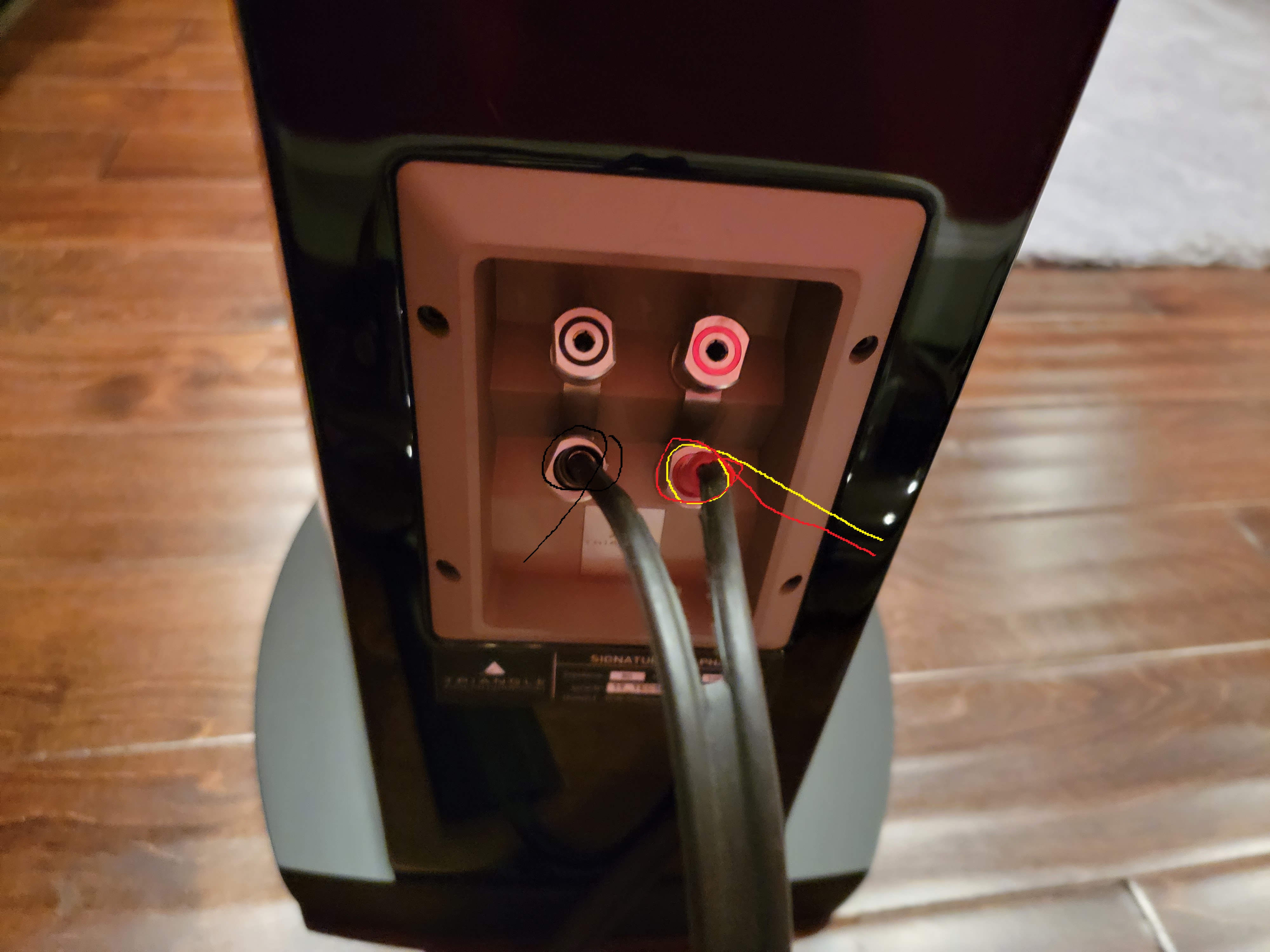

  1. To get the high level connection to work, Rel recommend connecting the SpeakOn cables directly to the speaker posts. Red and yellow go to the red or positive post, and black go to the black or negative post for dual sub configuration. Does anyone have this setup? I just want to make sure I don’t damage anything.

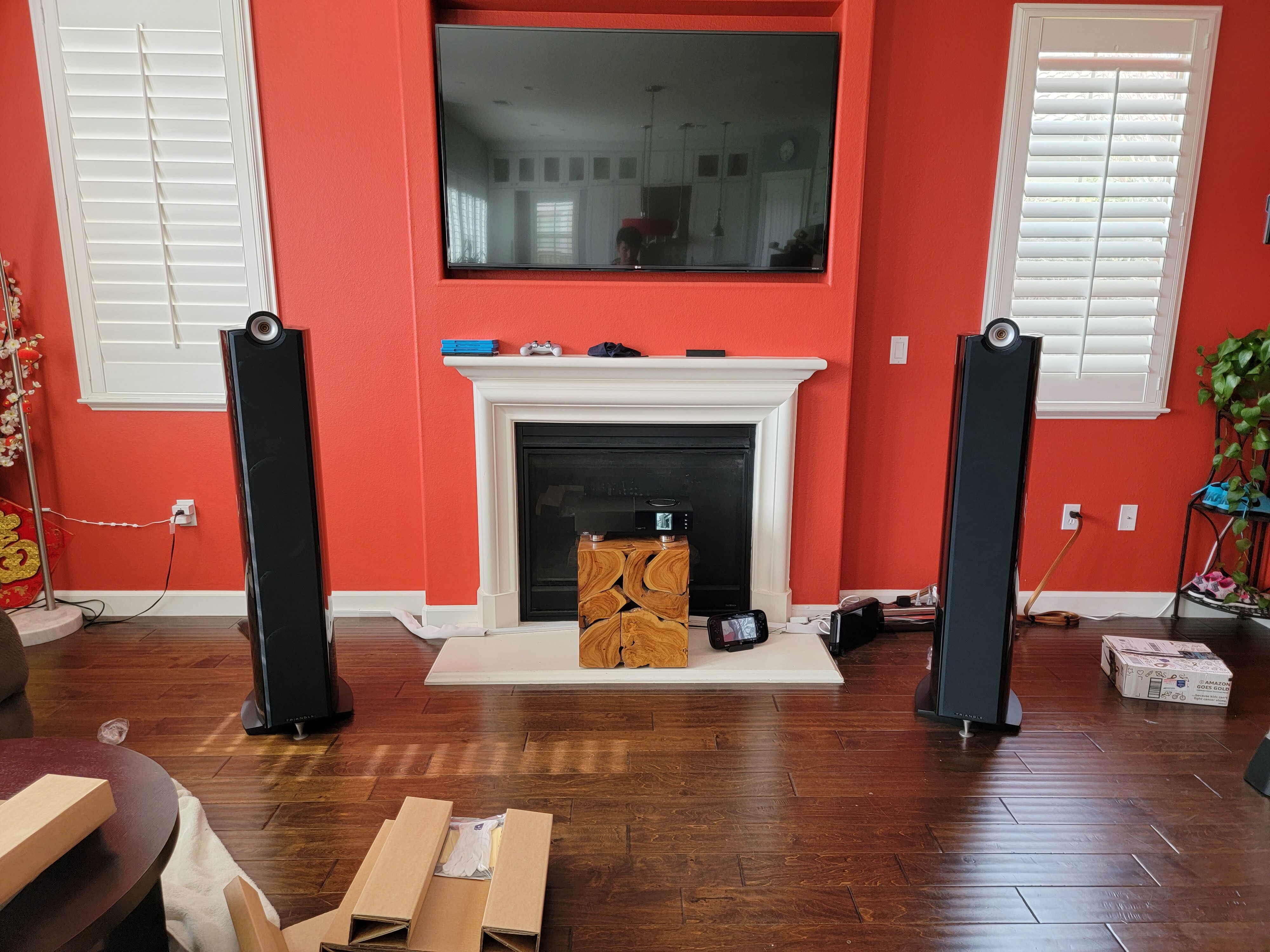

  1. In terms of sub placement. I only have the option to put them in the corners or next to the speakers on either side. Which option would everyone consider to start with? See my room setup.

This is correct for stereo sub connection.
ditto

I have a MJ Acoustics sub wired the same way and it works fine.
