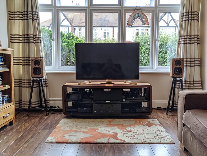

I used Proac Tablette 10’s with an Atom and it was a great combination. As the Tabs are sealed boxes they are able to go close to a rear wall. They sound best on stands but I had them on shelves initially and they were still very good
Another vote for Atom and ProAcs Tablette 10 Signatures. It’s what I have and love it.
