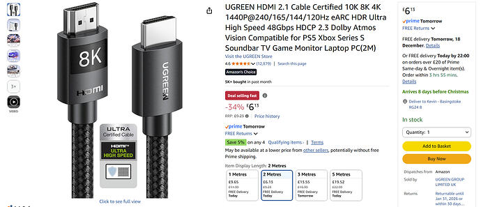

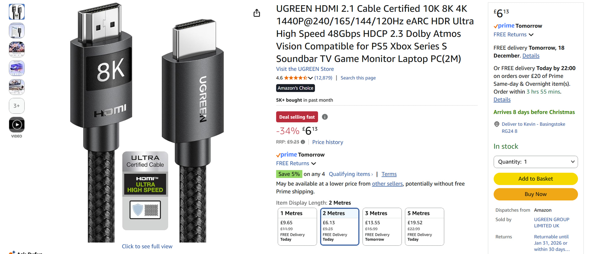

When i connected my Atom to a samsung TV recently by HDMI ARC, it was initially very flaky.
I replaced the standard HDMI cable that i was initially using with a new “8K” cable from amazon, and all has been well ever since.
This cable:
So not some fancy expensive cable, might be worth a shot.
It even powers up the atom when i turn the TV on.
ordered one, should be here today, thanks
