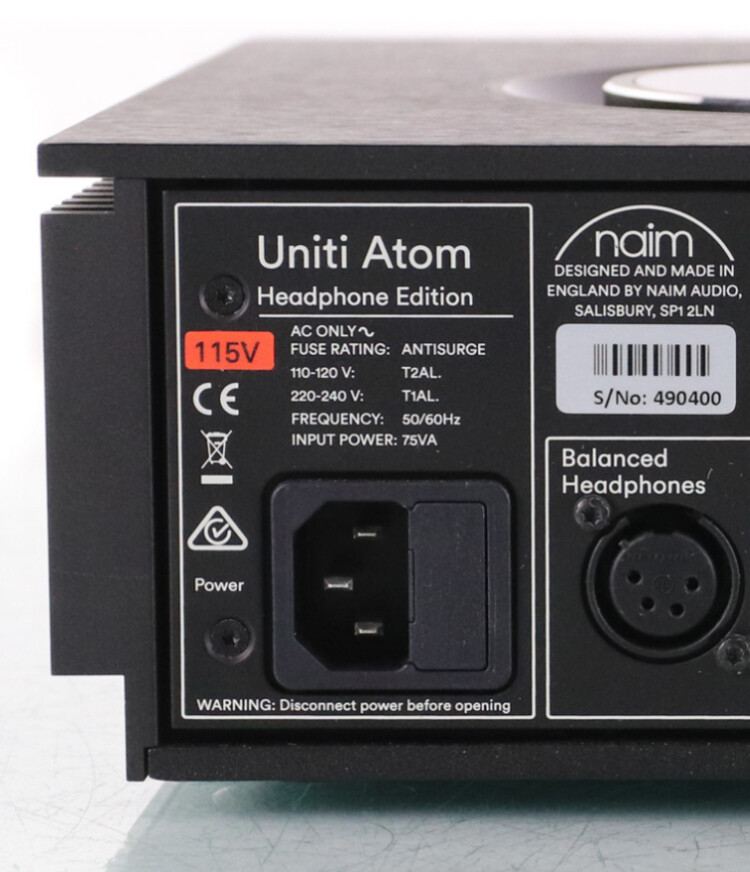

I’m attaching a photo of the power supply specifications:
It’s available as either 115V out 230V. The rear label of yours shows that it is 230V. You should definitely not try to use it on a 115V mains circuit.

So, the error code 4-2-7 at power on is because my house voltage is 115 V and my Uniti Atom is the 230 V version?
Richard suggests that. What can you do?

Yes, I ordered from a store in Spain. It never occurred to me to ask if they had the Uniti Atom in a 115V version. I ended up buying a voltage converter and it worked perfectly now. Thanks to you and everyone for your help.
