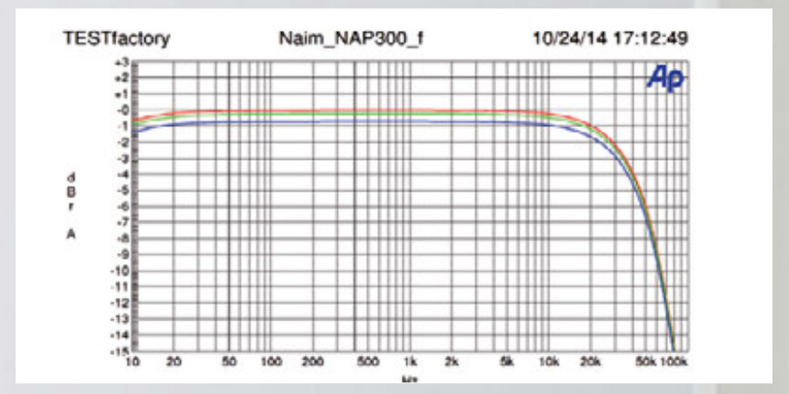

NAP 300 DR:

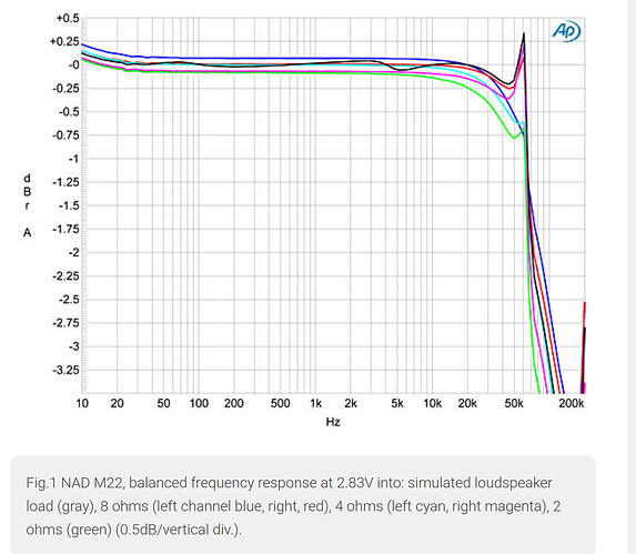

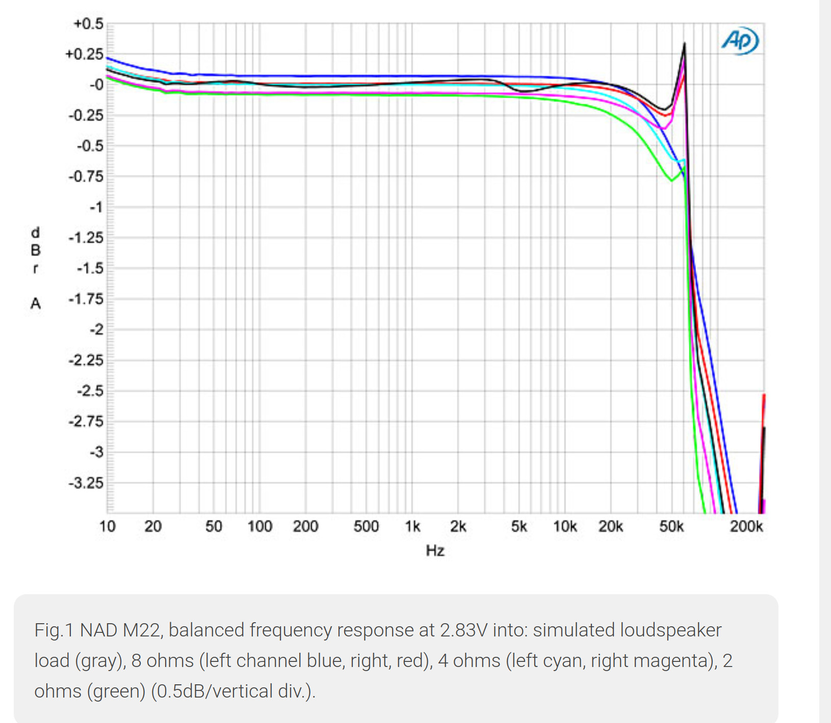

NAD M22:
The 300 has a 1 dB roll-off from 10 kHz to 20 kHz and the M22 has less, but this difference does not account for them being totally different amps with very different perceived sound, including what we call “warmth”/“cleanliness” because our vocabulary for these things is limited
