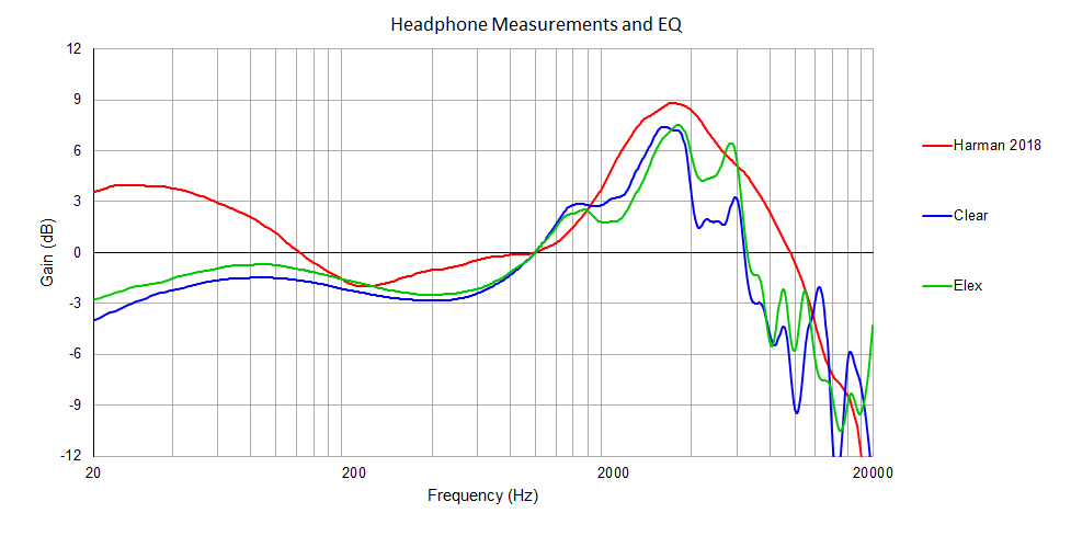

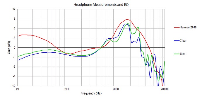

Yes but how does the response curve look? Because that is what determines how warm or cool the amp sounds:
The RME has adjustable curves so you can tweak the response to better match the headphones you are using:
I didn’t find a diagram for the 280, but if it has a max. deviation of 0.5 dB from 5 Hz to 70 kHz, it is essentially flat. The curves in your diagram have more than +/- 3 dB at 20 Hz,+6-9dB at 2 kHz, and ~-9dB at 20 kHz. These curves look either EQ-ed or are not actually measuring the amp but what comes out of attached headphones. No modern amp has default curves like this.
Edit: Found a curve for the 281:
The curves are headphone response measurements for the Focal Clear and Elex, compared to the Harman curve. The Harman curve is what we as humans generally find most ‘pleasant’ to listen to.
What the chart shows is that by default, the Focals have a slightly attenuated bass response, which makes them sound less warm. If you pair this with a amplifier that is completely neutral or also on the cool side, this could sound unpleasant to some people. So a warm-neutral sounding amplifier could be a good match.

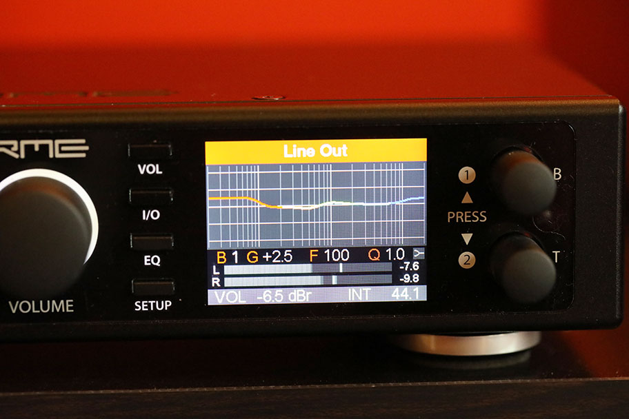

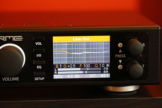

The RME allows you to make these kinds of adjustments (2nd image), by increasing the bass response slightly it will make the headphones sounds slightly warmer.
