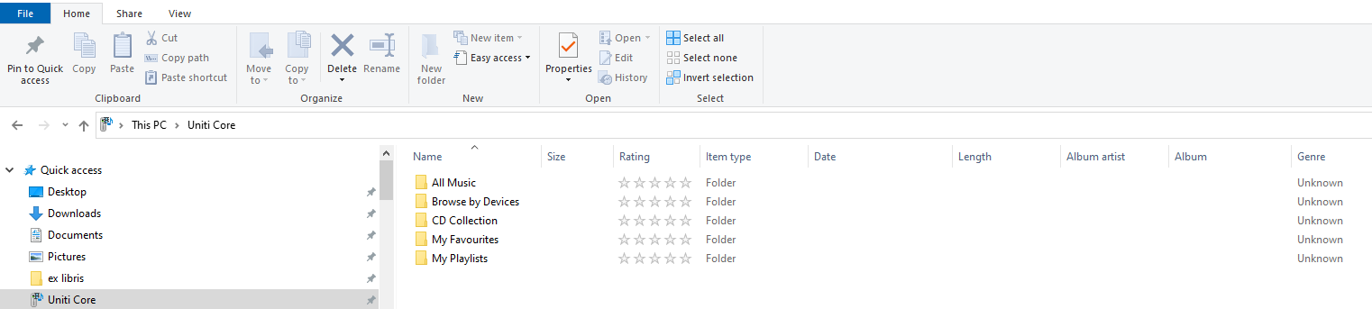

Please see screenshot of the path from my PC. (uploaded, hope it worked)
My understand is that I can load and delete files to the Downloads folder from my PC. But, I do not see the Downloads folder.
I suspect that this is showing you the contents of the core as a uPNP device, rather than mounting the drive in the Core as a network drive on your PC.
If you’ve mounted the Core’s drive, you’ll see a number of folders (including download, store, scratch and recycle bin).
If you know the IP address of your Core, you’ll be able to mount it in Windows by typing \ip.add.ress.here\ and pressing return (using the IP address - e.g. \192.168.1.51\ ) - this will bring up a list of drives that the Core has available to share, and you’ll be able to browse from there.

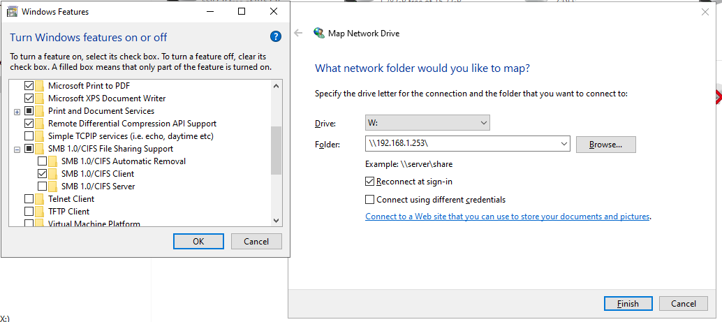

Last night I disabled, and then this morning enabled SMB 1 client, in Windows 10.
After SMB client was enabled, in Windows Explorer, I entered:
\\192.168.1.253\
(this is the IP in the Naim>About)
Windows could not find the Uniti Core.
Then, I attempted to “map network drive” via Windows, and that failed.
Windows says “cannot access”
Screenshot attached.
Thank you for any more ideas for troubleshooting.
You don’t need SMB1 for the UnitiCore (only for the old servers). SMB2 or SMB3 will be fine. So I would turn SMB1 off again if it were me.

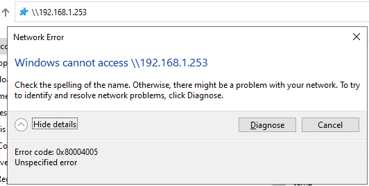

Hello david:
I followed the steps with care… but the results are the same.
Windows 10 gives an “unspecified error” code. (attached)
I also tried \\192.168.1.253\
but it also gave same error.

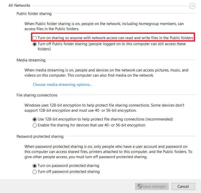

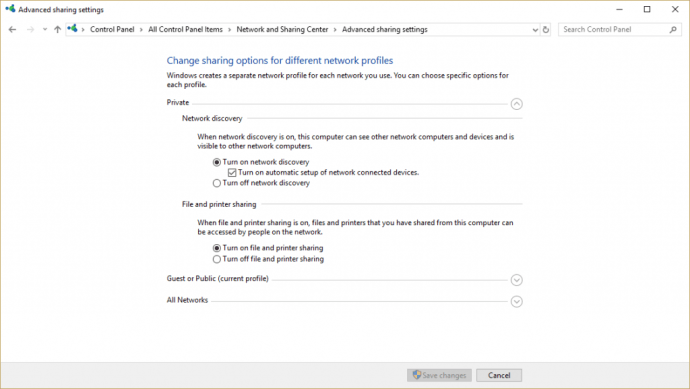

It could be a folder sharing thing.
If you are sure the network you are on is private you can relax some login security.
Try
Accessing a Shared Folder That Isn’t Password Protected

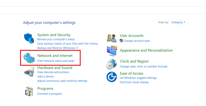

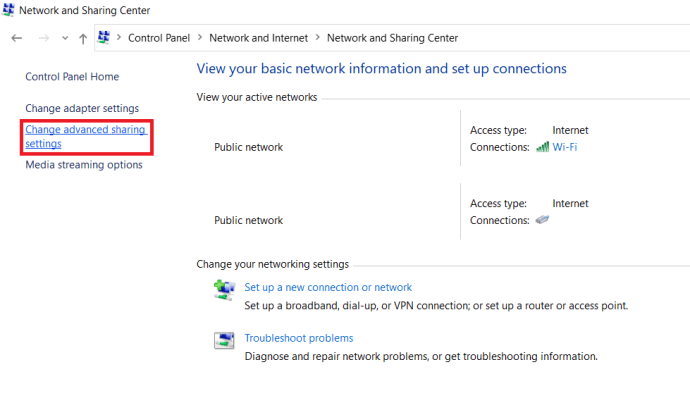

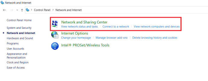

  1. Type ‘control’ into the Windows Search bar and select Control Panel, or you can go the the Settings page.
  2. Next, select Network and Internet.
  3. Now, select Network and Sharing Center.
  4. From Network and Sharing Center, select Change advanced sharing settings.

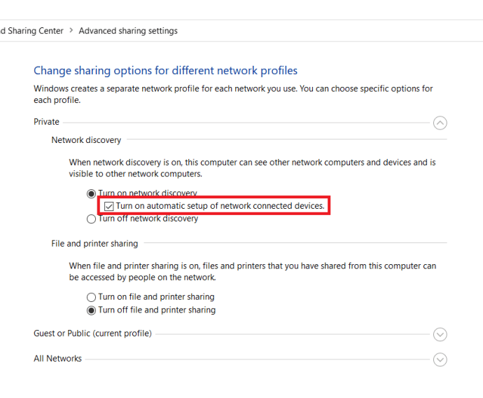

  5. Ensure Network discovery and File and printer sharing are enabled for the Private, Guest or Public and All Networks.
  6. Check the box next to Turn on automatic setup of network connected devices where applicable. Network sharing settings

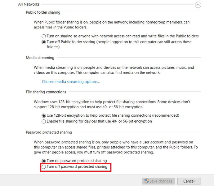

  7. Now, under All Networks, toggle Turn off password protected sharing. Network sharing settings 2
  8. Under All Networks, make sure to turn on Public Folder sharing. Shared Folder Settings
  9. Click the Save changes button to apply the new settings.

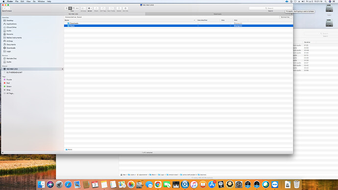

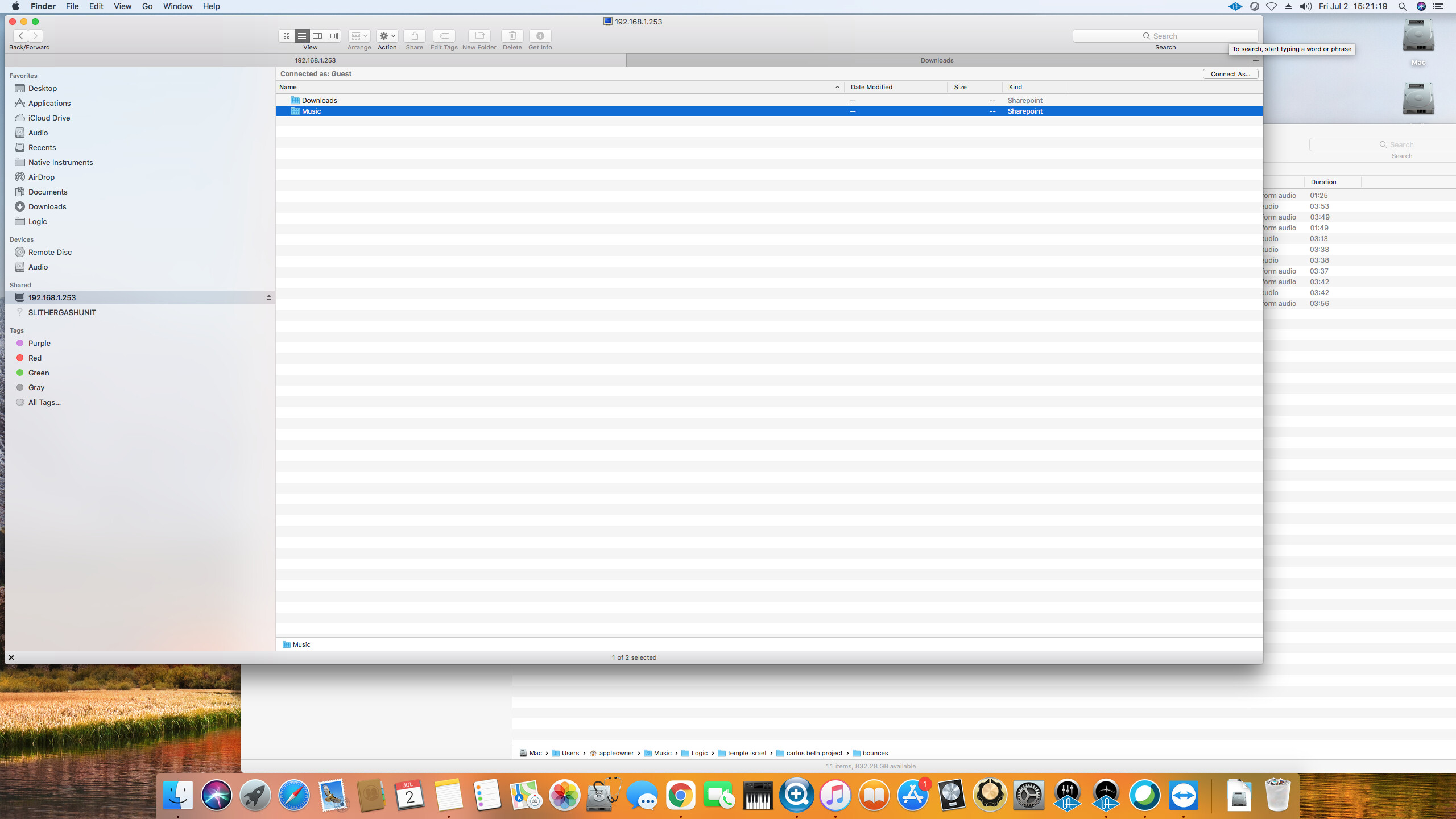

Hi davidhendon and Kryptos:
I have an iMac on the same LAN. I made an smb connection via Finder, and that seems to work. (See attached.) Logged on as “guest”, I only see two folders: Downloads and Music.
I can move files to Trash from the Downloads folder.
I am not able to create a folder on the Core. (Assume this is normal.)
So, this seems to put the ‘blame’ on a Windows setup. That was my hypothesis from the start.
I will step through those Windows settings, to see if I can get access via Windows. That would be my preference, but not a huge problem if I cannot get it to work. But, I will keep trying.
But, for now, I think I have enough functionality.
Thank you for your assistance. Much appreciated. :slight_smile: :musical_score:
That is what you would expect to see on a Mac, so at least you have access to the Downloads folder if you need to add to it or make edits. Don’t worry about the ‘Guest’ login, there is no need to provide a user name and password.
Back on my Windows 10 PC now, and all my settings matched what you recommended except the Password Protected Sharing setting. It was “turn on.” I set it to “turn off.” And Saved Changes.
Then, in Windows Explorer, I entered \\192.168.1.253
and it errored, in the same way as before.
I will try rebooting the Windows 10 PC, and try again to connect to the Uniti Core. I will report back if I can connect.
