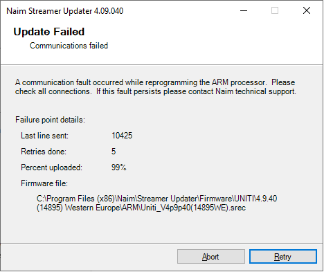

I performed last week the upgrade my Uniti 1 (With the later 24/192 streaming board) from version 4.6 to 4.9. At the end of the ARM upgrade phase, the update failed with “ Communications Failed” reason. In details, the upload stopped at 99%.

At last, I monitored the traffic on the serial port during the upload and noticed that the last data block (probably the last one because it is really smaller than the previous ones) sent by the laptop is considered as “NACK” by the Naim unit, and after 5 retransmissions with a “NACK” reply, the link is released.
I do not see what could have an effect on this last block to consider it bad.
