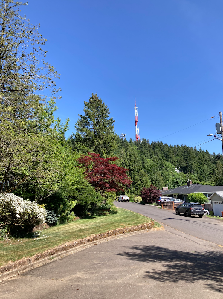

  • There is really bad RF interference at my house. There is a large radio tower in view. I, however, haven’t had significant issue with previous receivers (a 1980s Kenwood, a 2000s TEAC).

I have to say it does sound like some kind of RF problem. I am a bit concerned about the fact there’s a large transmitter nearby as this can be a problem in some countries. However, if you can test the Z-wave first then that can at least be counted in or out of the equation.

For reference, here is a picture of the radio tower that’s in view of my home.

It could very well indicate that the speaker leads are acting as aerials and are picking up interference from the transmitter. If you are able, could you try moving the cables around - try, the runs close together then separating the runs and see water any of that makes any difference.
Otherwise it could be something being modulated by the RF on the amp output. In which case, It would be worth discussing this with your dealer and seeing whether another example may be less affected.
I’ve known high power transmitters to do some very odd things - even preventing some kit from working at all. In the UK and Europe I think transmitters have limited power so such things are usually avoided, but in other parts of the world, not so. I’ve known a few incidents of this in the US and Canada (indeed, experienced one-such myself in a hotel with a powerful transmitter on the roof) and at least a couple more in the far east.
