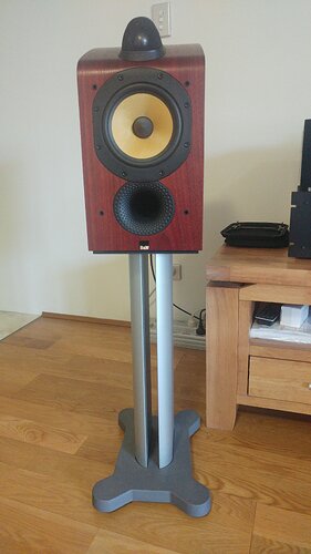

You need proper stands. The problem may very probably come from the absence of stands.
Oooh I have these stands with my BW CM5’s. Good stands filled with sand. Heavy stuff.

Good stands and generally good support from vibrations give a cleaner sound, more natural. But we don’t know if it will remove the brightness. However it gives a more organic sound, with better low end.
Indeed. B&Ws are prone to wooly bass and I share the experience that good stands makes the bass much better.
