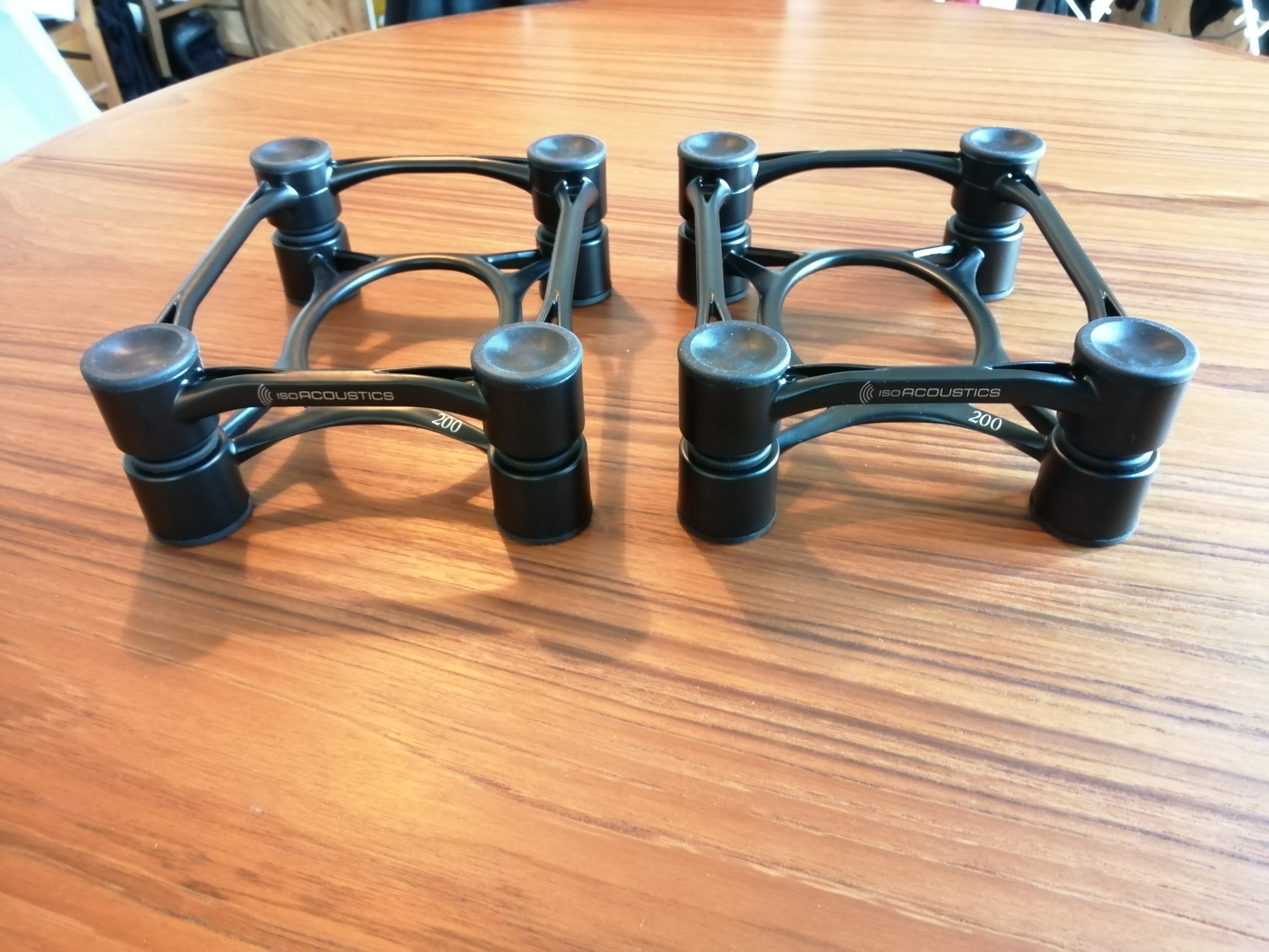

You have also the Isoacoustics Aperta. Good isolation and can be placed on your rack.

Adding some better quality vibration control (such as that which @frenchrooster suggested above or similar) I think should very likely complete the transformation (obviously I can’t be certain, but I do hope so). Remember that with your hands you won’t be able to feel all types of vibration - some is too high a frequency and some will be travelling along the shelf rather than going up and down.
