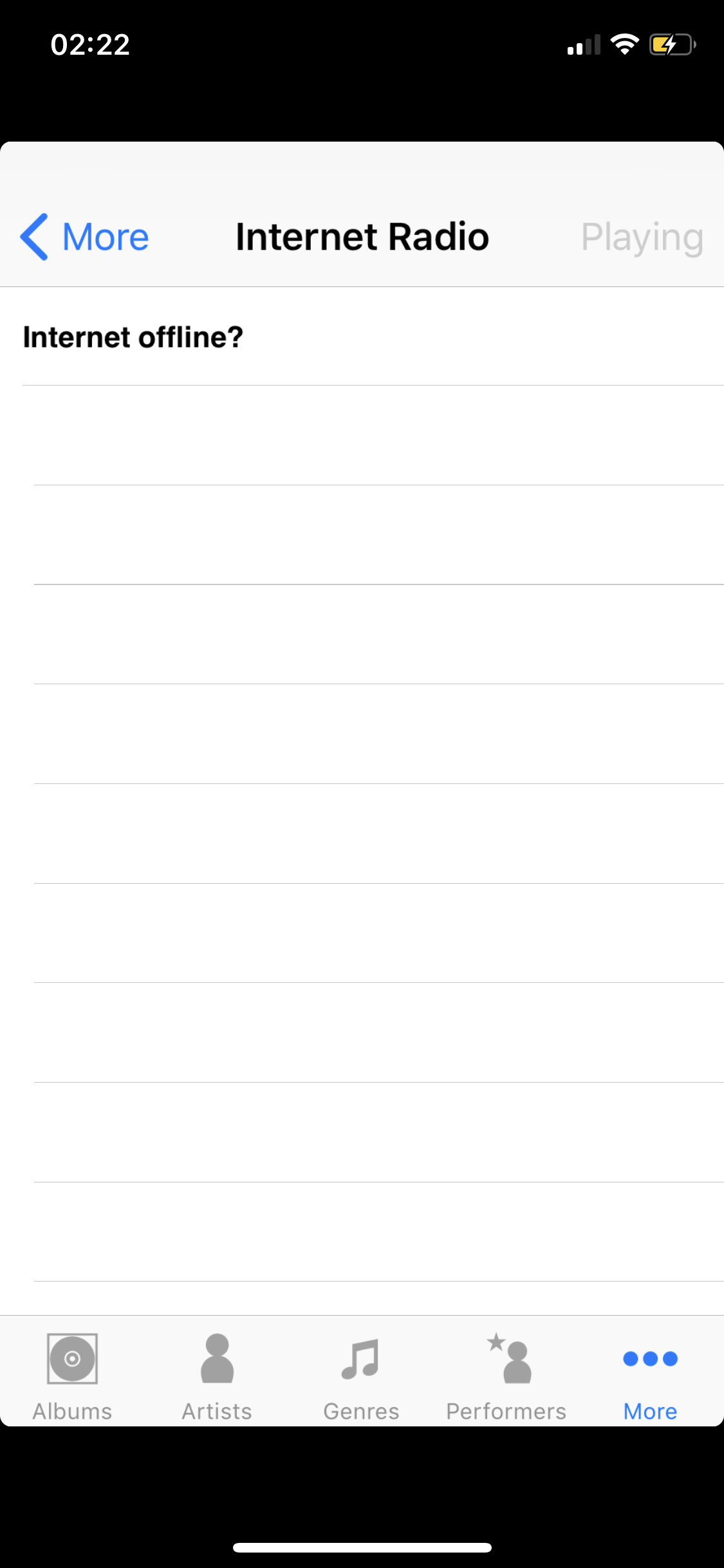

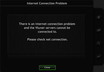

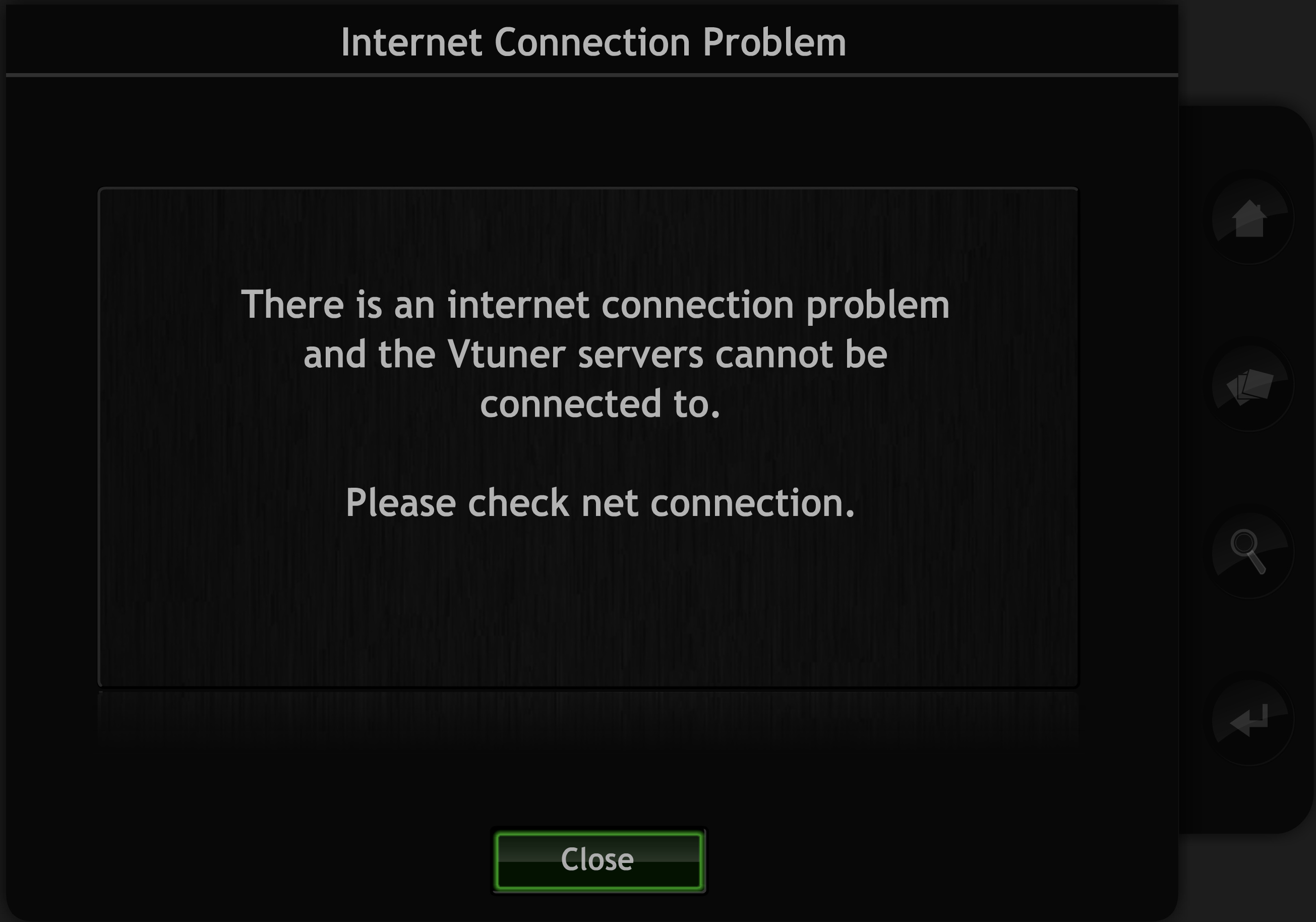

After familiarising myself with the device… ripping my first few albums, I tried using Internet Radio. On the iOS client I get the error ‘Internet offline?’ and via the web.. "Internet Connection Problem’.

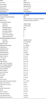

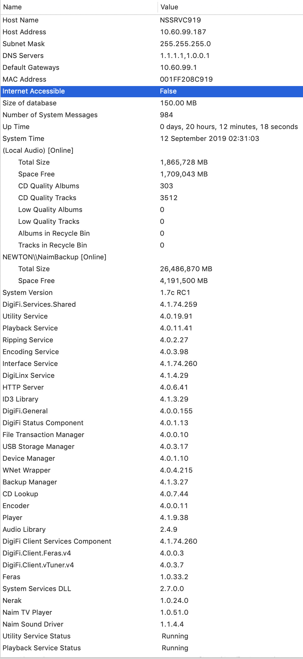

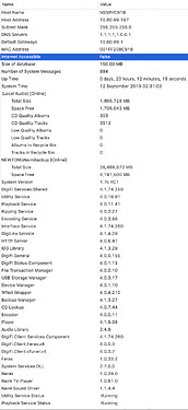

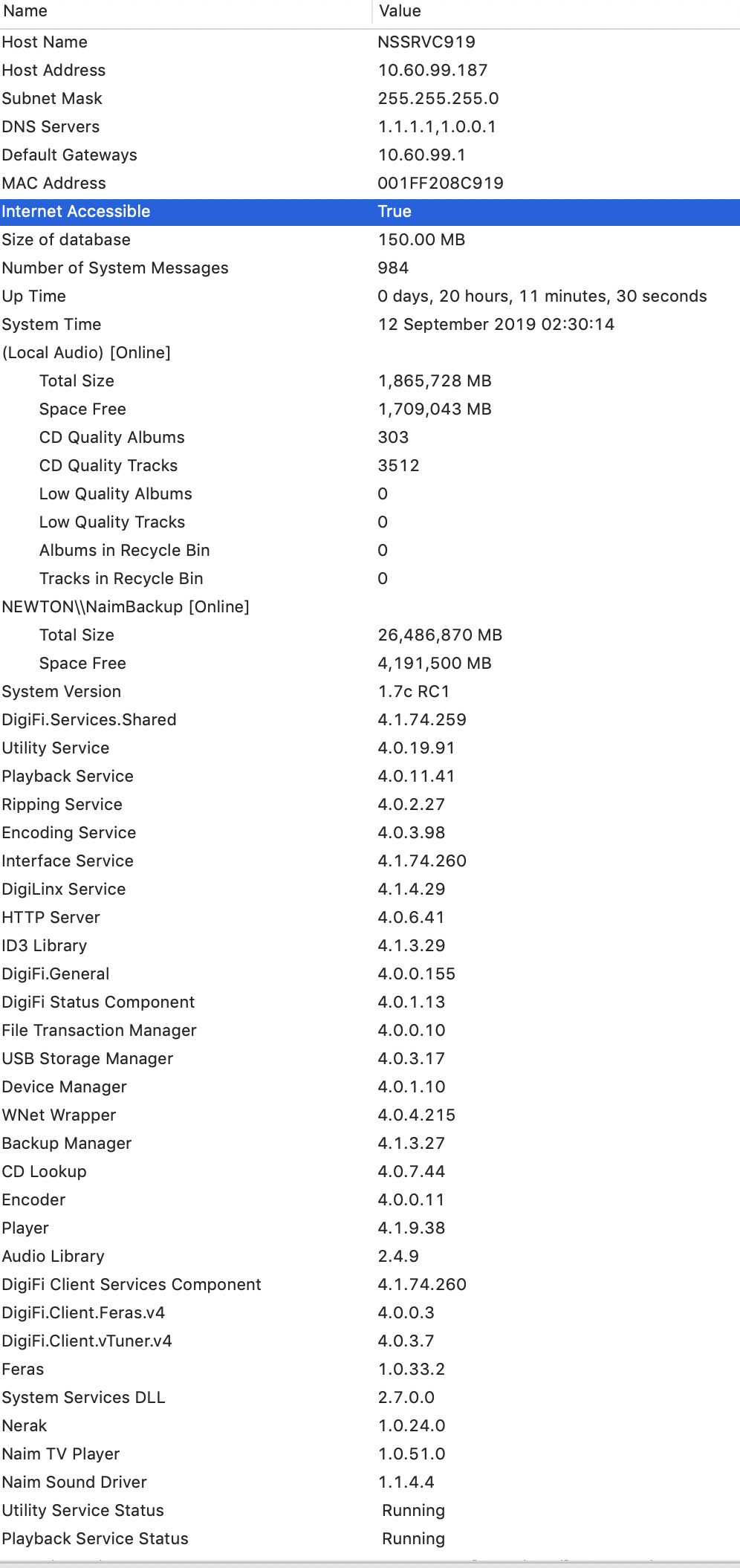

When connecting using Windows/OSX desktop client, I can see within the Unitiserve status that the device is mostly reporting no Internet access. Every now and then, when I click refresh on the Desktop Client Internet Accessible shows as True

Is the Unitiserve still using that IP address that shows in your screenshots? That looks to me like a private IP address that can only be accessed on your local network, which might explain why you have no internet access. Looks like your router has a similar address, does it not use the more common addresses which normally start 192.168…?

What I don’t understand is that the two odd IP addresses appear in both the screenshots, one with internet, the other without. I would certainly investigate the possibility that this stems from a static IP address having been set in the past, but why, then, is the fault intermittent, and why does the router also appear to have an odd IP address?

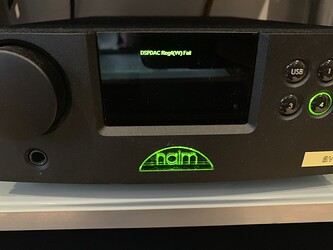

You may indeed :wink: I did as requested earlier (by one of the very helpful Naim support staff) and switched from coax to fibre to recreate his working lab environment; which did some really quirky things!! including a DoS of my DAC-V1…
I didn’t take a photo of the other error, but it reported it was ‘unable to re clock’ and again made the DAC-V1 unresponsive.
After the third reboot of the DAC-V1, it connected over Fibre @ 44.1Khz but sounded awful, with clicking and all sorts of peculiar noise.
A reboot of the UnitiServe brought back stability, but coax/fibre makes no difference to my Internet Radio issue.
I’m finding that maybe 1 out of every 30 attempts at browsing Internet Radio brings up the ‘first’ hierarchical level of Internet Radio, the screen where Naim suggested is one of the options… selecting anything at this stage triggers the ‘Internet Not Connected’ cannot connect to Vtuner servers fault.

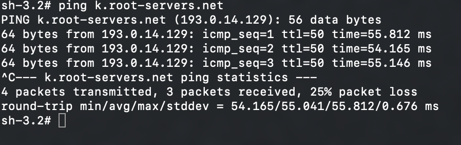

Have investigated your issue and I think the problem is that your firewall is blocking access to some root domain servers, that Unitiserve uses to decide if there is internet present or not.
The system pings various root domain servers and if this is blocked then it will go into no external internet mode.
Address wise you will see pings on addresses like 193.0.14.129. The domain details are:
inetnum: 193.0.14.0 - 193.0.15.255
netname: RIPE-NCC-K-ROOT
descr: Subnet for k.root-servers.net
descr: See http://k.root-servers.org/ for details
country: NL
Overall ensure the server has free access to the internet on all ports, including ICMP.
