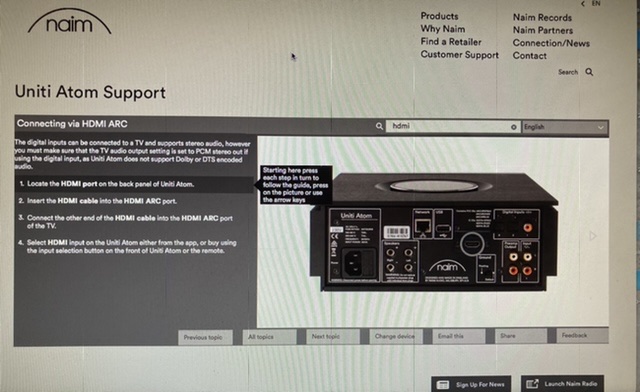

The HDMI on the Atom is HDMI ARC for use with the Audio Return Channel enabled HDMI on a suitable TV. You can’t use it to directly connect a regular HDMI socket on something like a Blu-ray player.
If you have an ARC enabled HDMI socket on your TV try connecting to that.

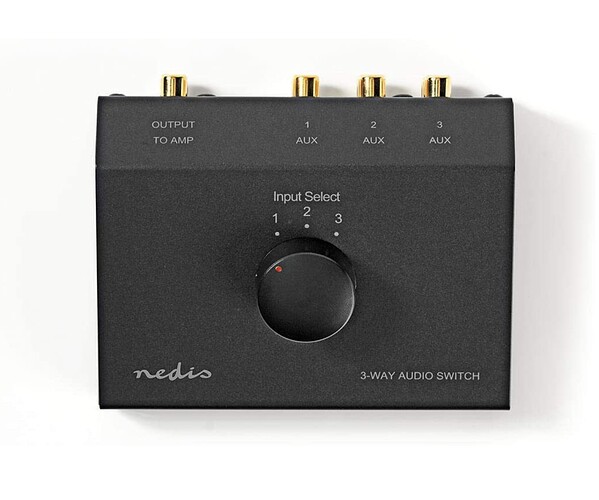

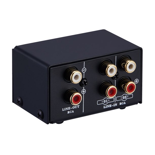

Maybe something like that could help? Sort of RCA switch.

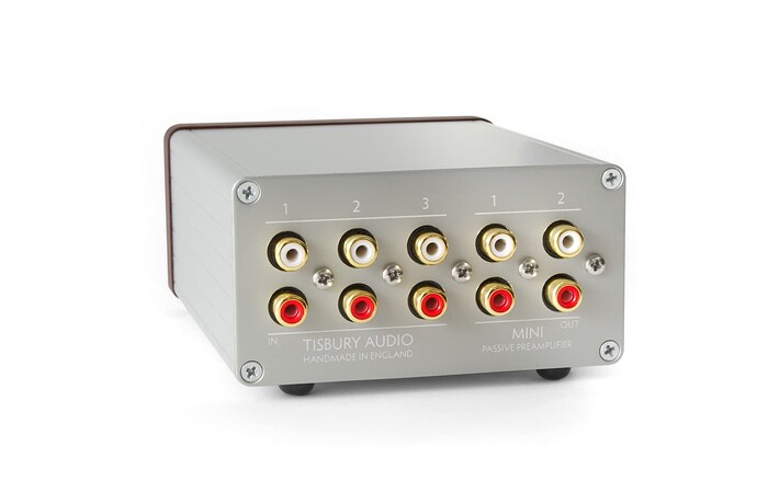

That’s not a bad idea. There are plenty of passive preamps that would give you the same eg Tisbury Mini Passive Preamplifier II

I have just ordered one of these for now, @£25 it’s worth an audition. May look into a Timsbury passive when funds allow, bit too close to Christmas and I have just bought another amp…

The interactive support pages cover HDMI connection in detail.
OK Richard, thank you I’ll take another look, must have missed it previously.
Well, clarity, detail, and volume all suffered a slight drop.
An increase in volume just about brings some semblance of respect to vinyl reproduction, but I am sorry to report that cd playback is flat.
Nope! I have just connected direct to my Cyrus phono and I know I’m listening through my trusty Cyrus phono sig!
Direct rca connection to cd is far superior too!
Okay, £25 is not a lot, but I am wondering whether Investment in a passive amp (as was suggested earlier) Would be worthwhile?
Ah well, I’ll pour myself another glass of Merlot, spin another disc and ponder…
