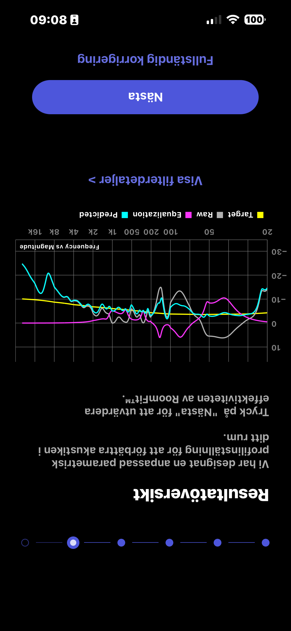

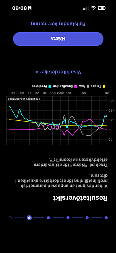

Looking for something to hook the wiim into which is less money than the atom. Or better.
Pic below indicates room correction needed.
So UQ is ”out”. V1 conpared to a modern budget DAC (ie Wiim line into the NAP 100 or digital via V1 into the nap?).
