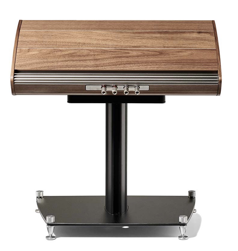

There are 4 connectors on the speaker. Remove the links between the two red and two black connectors.
Using two runs of speaker cable, connect one channel of the 150 to the treble section connectors and the other channel to the bass section connectors.
