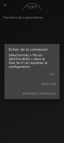

Another interesting thing is that sometimes afyer a reset the wifi name published as AP by the Qb2 is not what the app is looking at…hence it does not find it..
Name published as AP:
Name looked for by the app:
I’ll do another reset. I always push for > 10 sec
