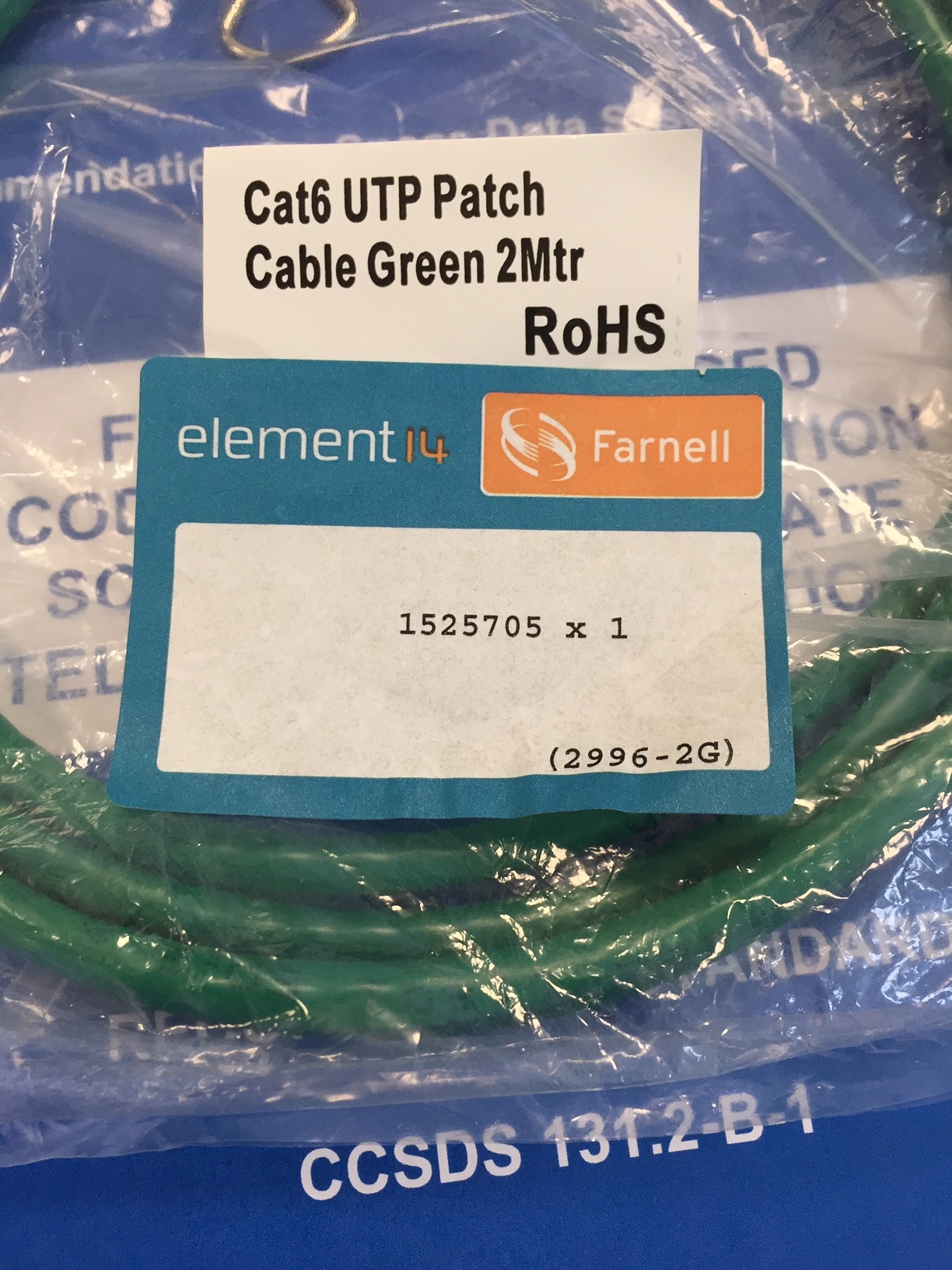

Peder - actually I have. I borrowed a Chord Shawline and a Chord Epic ‘Streaming’ cable to try as the last metre in my setup. Roon Nucleus > Cisco 2960 > 30m Cat 5e > final metre > Devialet 220 Pro. Both cables sounded different, but I ended up with a Farnell branded Cat 6 cable which to me sounded the best (IMHO). From a technical perspective I can’t understand what goes in to the engineering of an Audiophile Ethernet cable to make it so expensive.

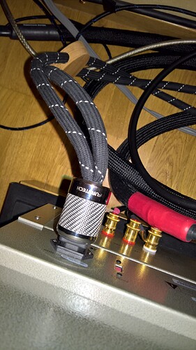

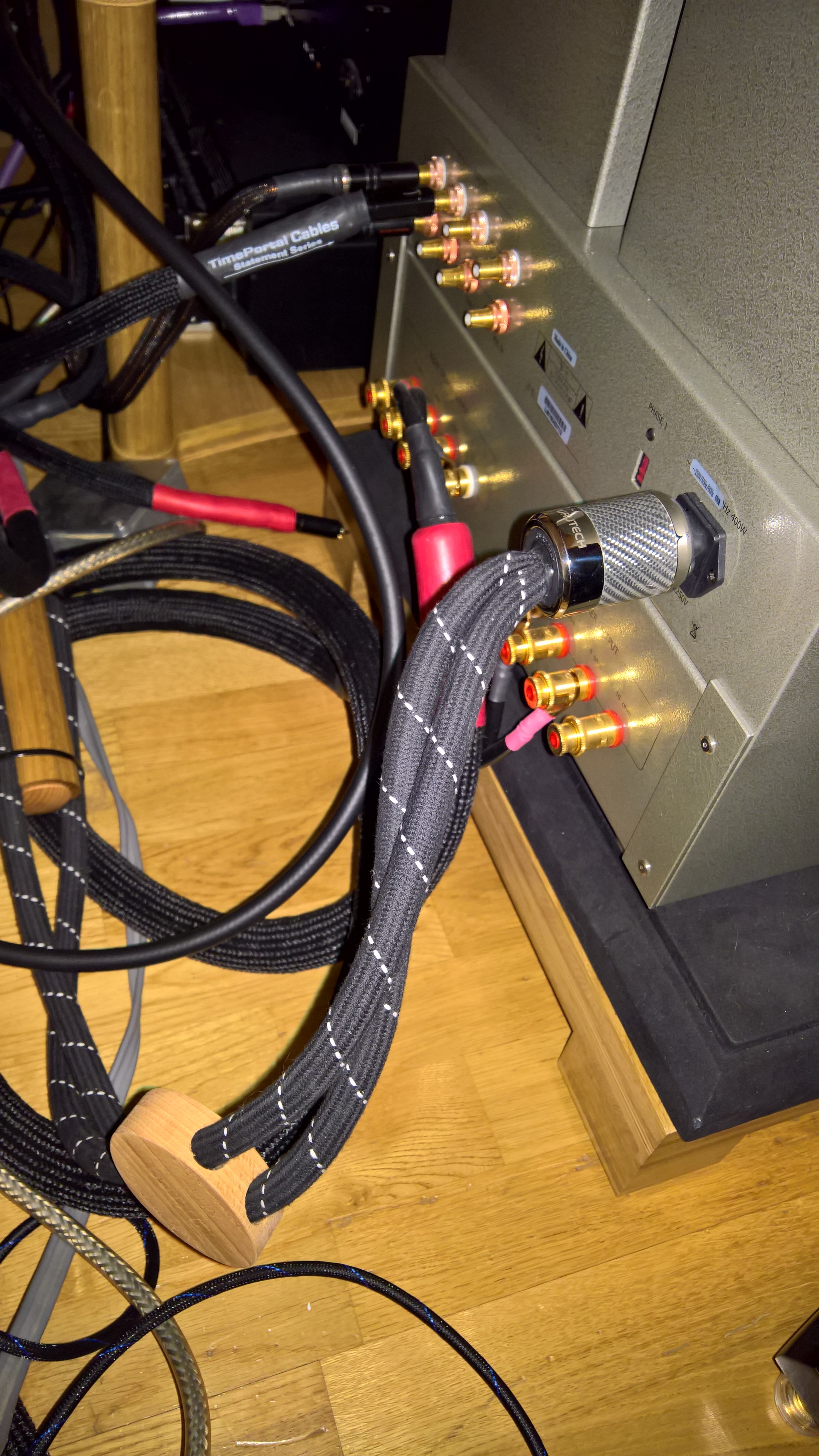

:small_blue_diamond:Swedish Entreq Powercable £ 7000:-.
:small_orange_diamond:Do not comment :grin:, I have promised to help him with cabledressing.

Or,.see the powercable on this two pictures above,.it costs in Sweden £ 7000:-.
According to me,insane money for a powercable.
But my friend,who owns the cable thinks it’s worth the investment.
/Peder🙂
