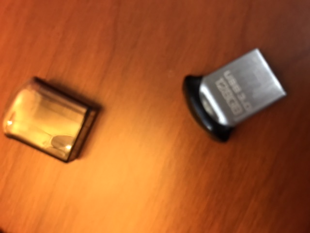

I use SanDisc USB3 128gb. And its enough ( for me)
( because its extra small/ pretty and most important, reliable : 4 years use/ no problems)
Sandisk is a solid choice, just be aware that those tiny ones whilst they are discreet do have a habit of getting quite hot in use!
A USB 3.0 device will be preferable mainly for the speed at which it writes to the flash. Read speed is not likely to be a major issue given the fact you’re only using it for playback of audio.

I have 1500 songs on a flash drive similar to the one above Sandisk 128GB USB 3.1, bought for £15 off Amazon. It works fine in the rear Nova USB port, however I converted all my files to .wav from .flac in DB Poweramp as there seems to be a consensus that .wav is better sonically???
