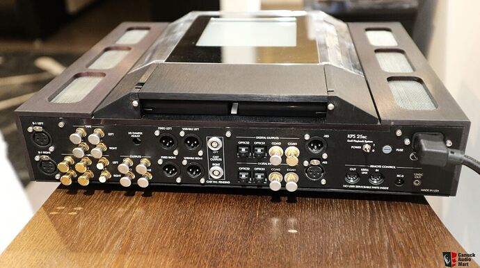

I can’t forsee any issues at all. Is optical the only output from your CD player?

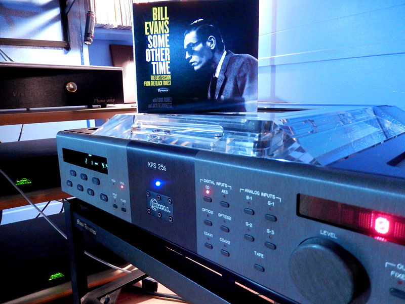

What a coincidence! I also use a KPS25sc ( but in S guise ) and WATT6 ( sans Puppies )!
I had mine since the intro (1998), replaced once by Krell and it has been serviced by Krell ( for several recapping ) but as Naim, they stopped servicing all CD spinner. But it is still a terrific player and it was a very special one for me so I was determined to get it fixed~
If there is a will there is a way. :nerd_face:
Not only he fixed it (it was a transport and laser issue and Krell no longer had the parts in stock) he replaced the older parts with new and I had him upgraded the caps so they can withstand the heat. This CD player will see me off.

I see Coaxial at the back. Wonder if it’s the same as SPDIF?
It is. All coax and Toslink connections are SPDIF.
digital - coax and optical
