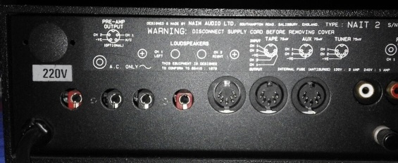

Using Naim Nait 2CB EU version 220V in 230V network
In the area where I reside, the power network voltage is specified as 230V (typically measured around 237V). Do you perceive any potential issues with using the Naim Nait 2 CB (rated at 220V on the label) within this network? Could there be any effects on sound quality or the longevity of components if the amplifier operates within this higher voltage range?

Using a 220V transformer on a 230V supply will create a small increase in the secondary winding voltage, but the filter cap ratings have enough headroom, so it will be fine.
