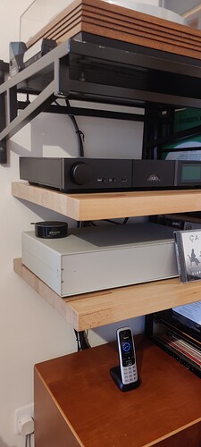

The recycled kitchen tops were cut to size, drilled for the invisible brackets and shaped to allow cables behind. £100 for these including fitting.

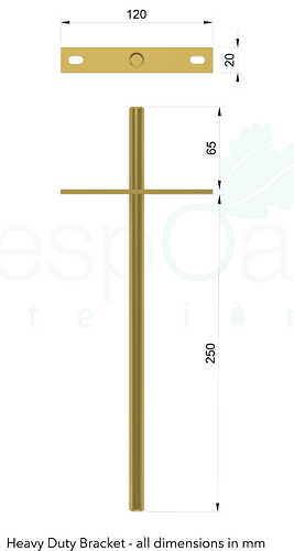

4 x 250mm Brackets came to £27. Secure but the build quality was so-so. Welds were a bit too large and they needed to the straightened. From https://www.bespoakinteriors.co.uk
Happy with the end result.
Nice one - looks great
Thanks. I’ll get round to making the cables less obvious. I’m thinking of plastic tubing painted the same colour as the wall.
