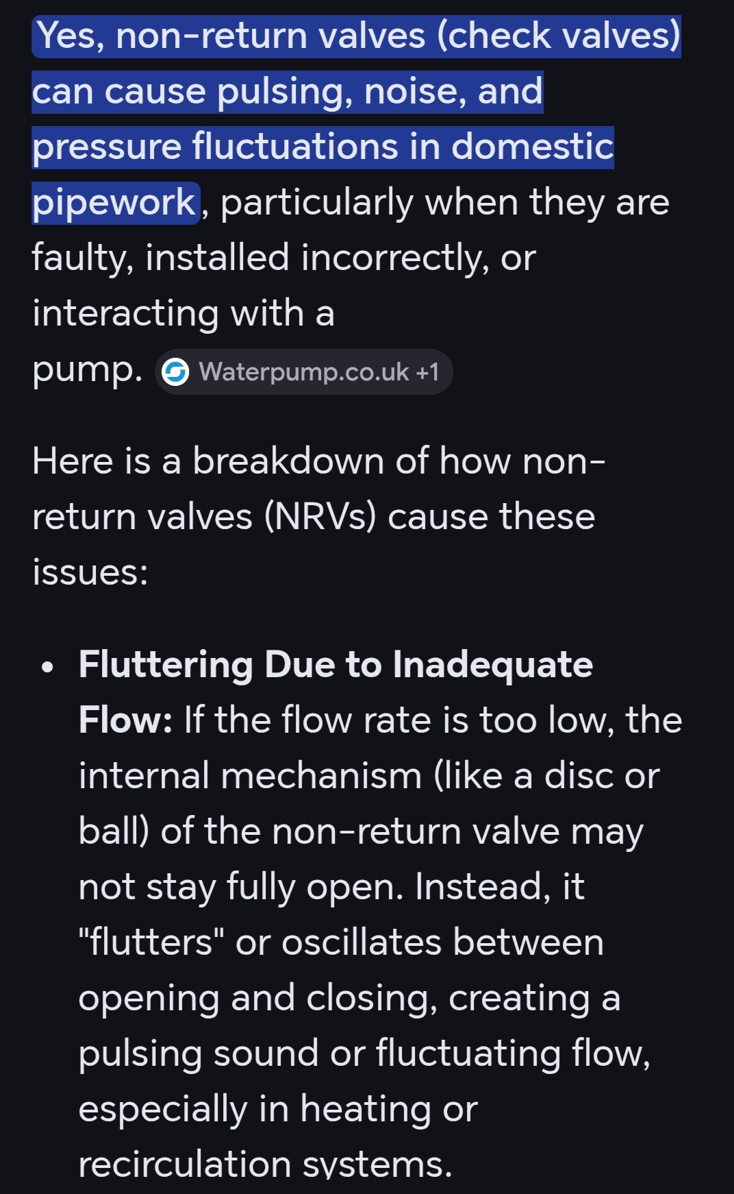

Non return valves can cause noise.
Maybe your new meter came with a new non return valve.
You could try opening or closing the stop kock a little to see if that has any effect.
