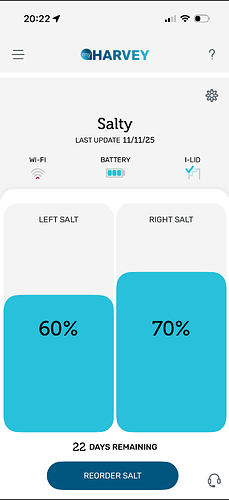

Knowing that James is a bit geeky, the latest Harveys have a sensor that alerts you when the salt is running low. We had a few problems getting the iLid (yes, I know) connected to the WiFi, so we got a visit from someone from Harvey, who happened to be the lead person in R&D who was designing the next generation of their softeners. Lovely guy, and we learned so much about the tech in softeners while drinking tea in the garden.
