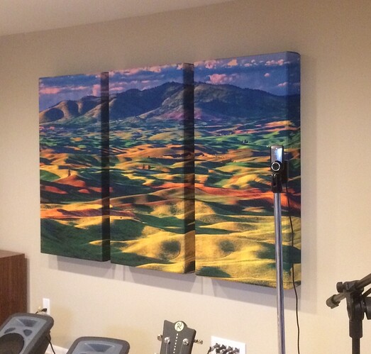

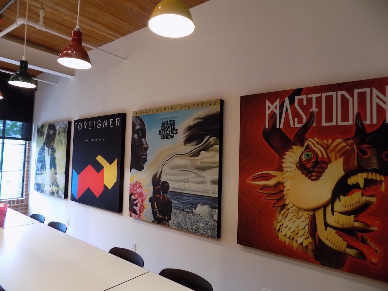

some nice art acoustic panels ( absorbing)
i like specially the bitches brew one( miles davis)
