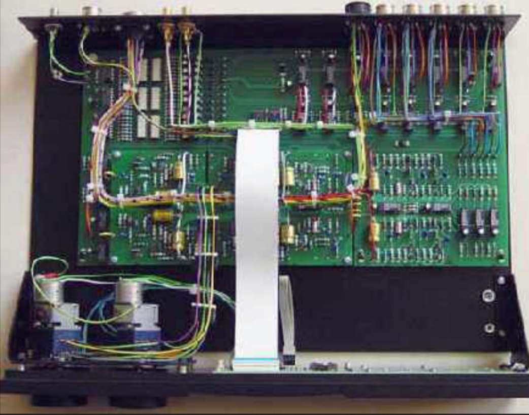

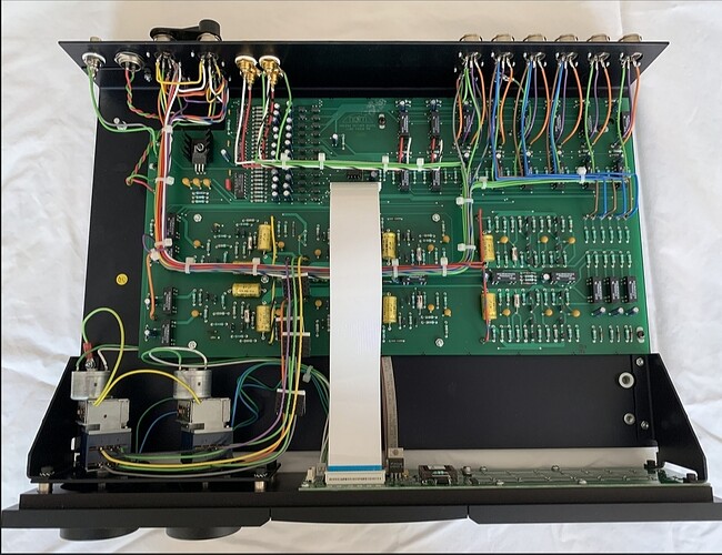

I’ll leave the technical details to others who know. Here are the photos of the 282 and 252. Spot the differences yourself. :blush:
(apologies for the low resolution image of the 252 as that’s the only photo I can find from the internet. Perhaps there are others who might have a better image quality of the 252)
282;—
252;-

If you look closely (hard to see from above) you’ll see that while they look superficially similar, the NAC282 is mostly on one large board, whereas on the NAC252 the boards are split. Layout is slightly different, obviously more wiring on the 252 as there are many more supplies from the Burndy connection. Componentry even more rigorously selected in places.
This photo of a show unit gives you a better perspective although you can’t see underneath the central board;

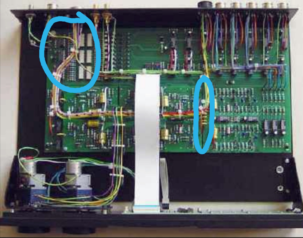

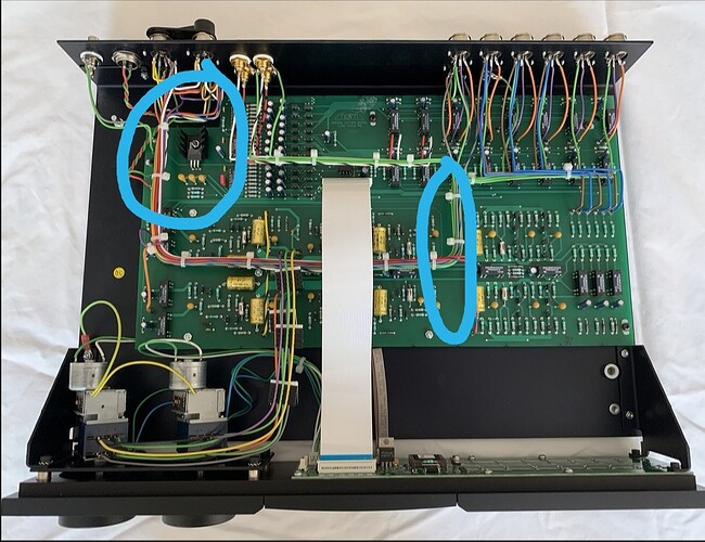

Slightly different at areas highlighted
NAC 282 ;-
NAC 252 ;-
