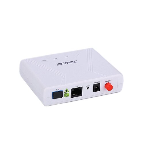

Generally with FTTP the provider will only install a fiber to ethernet module in the home, similar to this:
You can then plug any router into the ethernet port, for instance a BT smart hub 2.

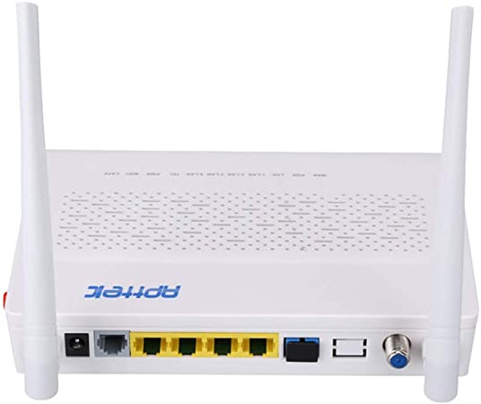

Some providers may install a more elaborate option that includes both a fiber optical modem and a router, in which case the extra smart hub might be redundant. It would then however still be possible to plug the smart hub into one of the ports for extra connectivity:
