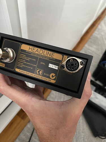

Hi, y’all. I recently purchased a secondhand Headline with NAPSC. Seriously great little amplifier. Anyway, the Headline doesn’t have RCA inputs or the installed DIN cable, but instead has a 5DIN input installed (see below).

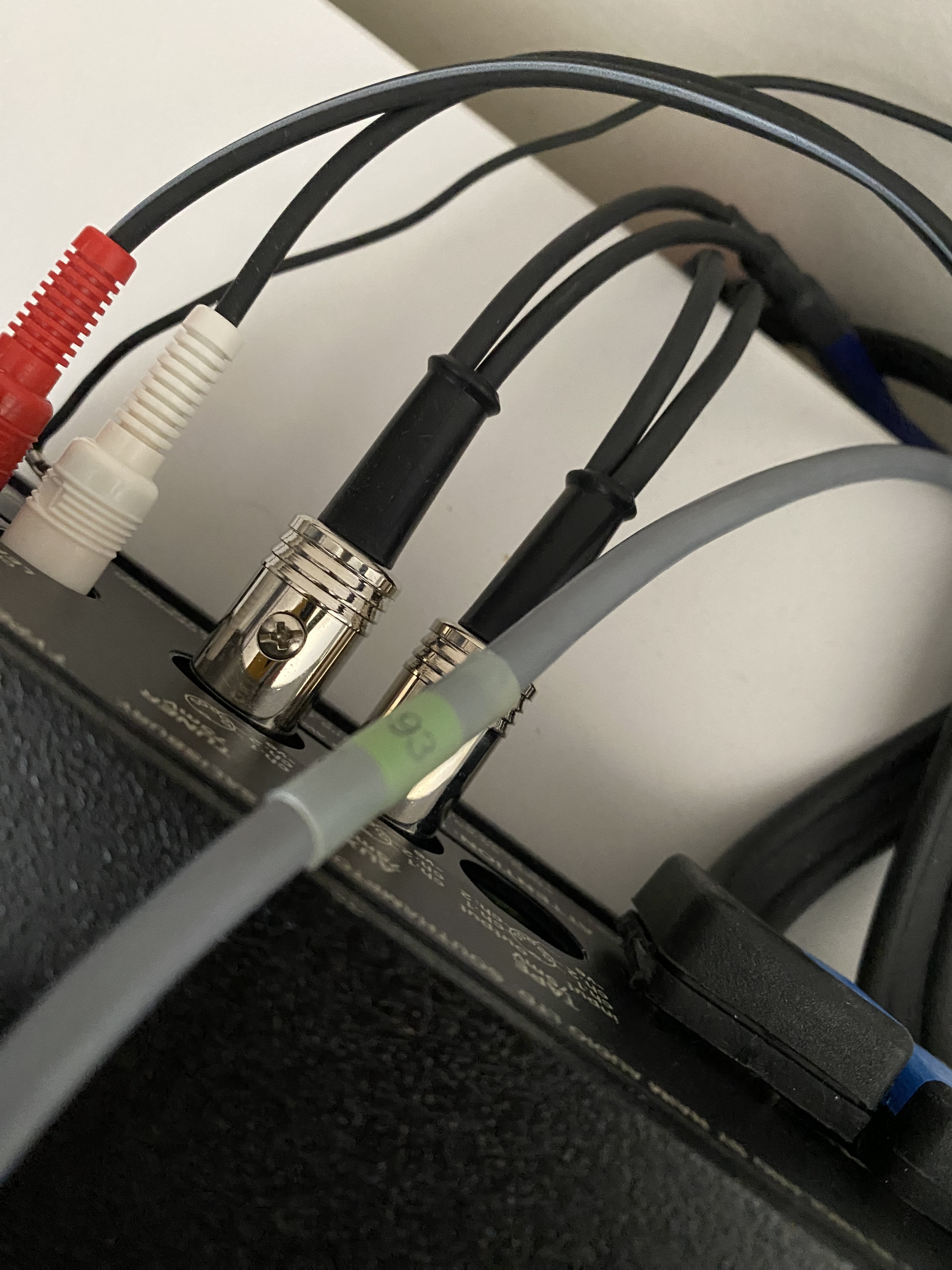

The interconnect it came looks an awful lot like your normal 5DIN>5DIN interconnect; however, after stupidly trying a couple other 5DIN interconnects, which produced no sound, I realized this special cable was maybe the all-DIN version of a 5DIN>4RCA cable.
Has anyone ever seen one of these? I have yet to see it listed or mentioned anywhere. Per the last owner, the amp was serviced by Naim, who I presume also installed the input, but I really don’t know. Any insight? BTW the green directional band has “NA-93” on it.

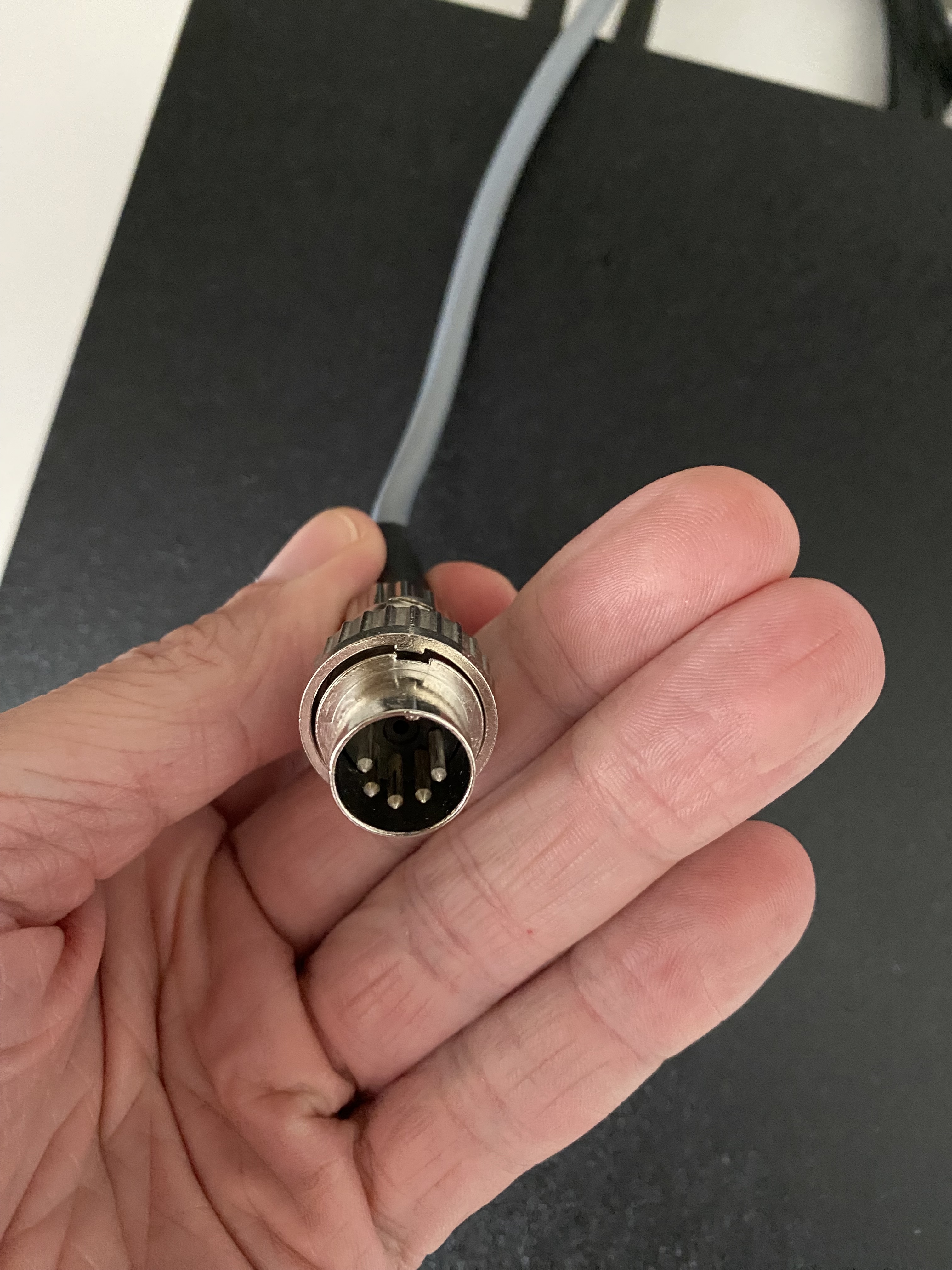

It will have 3 pins connected to take the output from the preamp rather than all 5 to act as input as well.
The green band number is to identify who made it at the factory.
IMG_6096
So it’s just a standard 180 DIN>DIN customized with those specific pins activated and the two IN channels deactivated? Interesting.
That is the ID of the person that made it (as @robert_h says). Now you know… :thinking:
Not A Part Number.
The lead could be a fully wired (using all 5 pins) lead - or it could be a Tape Output (only) lead. Either will work in this application. But… a normal DIN input (only) lead will not… :expressionless:
Know Your DIN Pins.
If it came with the Headline it could well be a modified Naim interconnect with the REC pins connected at the amp end, as opposed to the normal PLAY pins.
I’ve seen a few of these Headlines done with a DIN input - IIRC @kuma of this parish uses one like that.
Thanks for the knowledge, everyone! Was asking in case I ever needed to replace it, in which case it’s sounding like it would be a custom job.
Or a fully wired 5 pin both ends will always work. On the headline end, the 2 pin holes on the left of the socket aren’t connected to anything.
