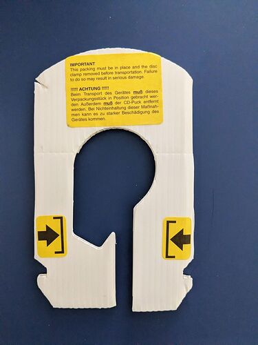

My vintage Naim CD2 originally came with 3 transit screws as well as transit packing pad (see attached) that looks like going into the tray but not sure how to put this in.
Does anyone know how to put this pad inside CD Tray?
The warning message is strongly suggest to put this otherwise can cause serious damage during transit.
Thank you very much in advance.
The pad is to brace the mech inside the tray. I’ll see if I can find a picture of one in place…
Thank you. I thought that it is to hold laser or spindle tight but could not figure out how to put this. It does not seem to fit tight any angle that I tried. (scratch my head)…
Here you go, an old image from the forum…
Thank you very much, Richard. It helped to figure out and here is the photo after inserting the protection pad.
Hope this is helpful someone like myself who is novice in Naim gears when they move their gears in the future.

And apologies, sincere apologies, I’m not assuming you won’t know this but I’d kick myself if I didn’t at least mention this and it just got overlooked with all the distractions we deal with - please don’t leave the puck on the tray if you are shipping the machine. It’s years since I moved mine but I think it has a space in the packing foam.

Great point. The transport pad has sticker on it and it states that the packing pad must be in place and remove disc clamp before transportation. I removed mine when I placed the pad earlier today and put into another plastic bag so not too lose it.
