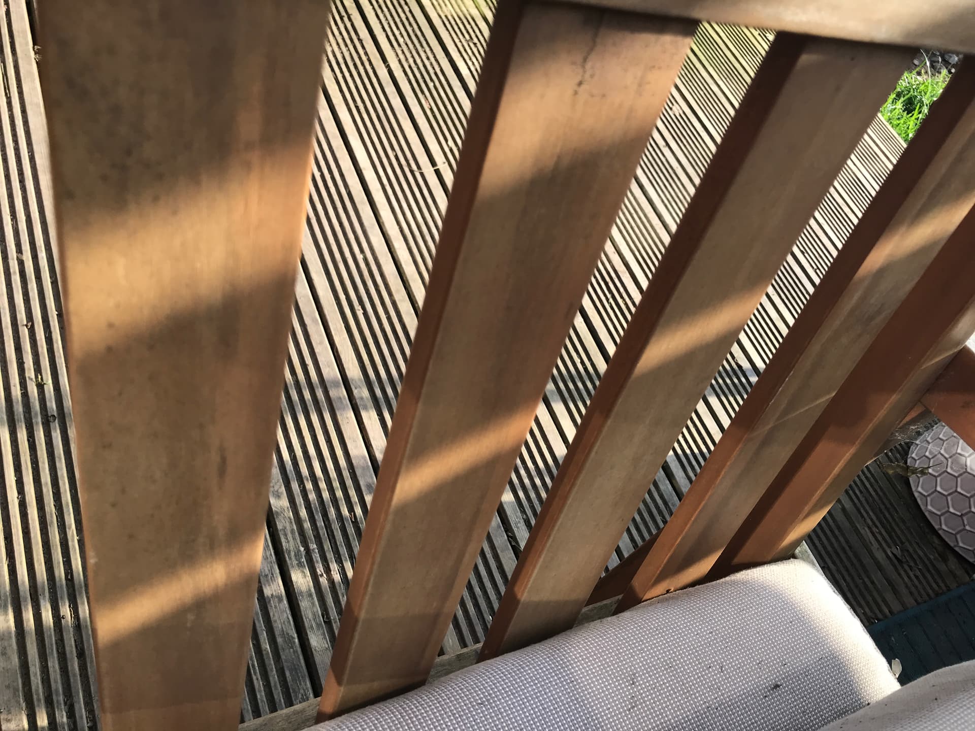

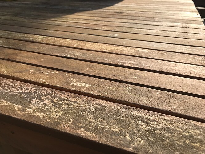

Here is what needs doing:
  • Arms on x5 armchairs
  • Dining table top (180 x 90cm)
  • Coffee table top (102 x 60cm)
Adverts from website states the following:
Shade = Taupe
Finish = Oil
Here is what the furniture currently looks like:

Judging by your photo it looks to me like there is an old finish that has broken down, possibly a water based wood ‘oil’ on top of the original oiled finish? Sand this off and apply some proper teak oil, and I think it will be fine.
All this talk of oils gets confusing, but teak oil is just a generic term for oils that have thinning agents added to improve penetration into naturally oily timbers into which they are not easily absorbed. This includes teak, thus the name, and other tropical hardwoods, but also acacia.
