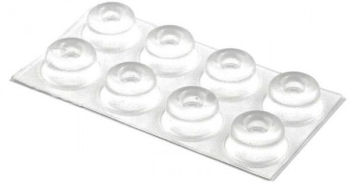

Can’t really afford heavy duty jobs at the minute nor would i think it’s worth it really. I think the floors are made of floorboards and not wood, i think chipboard, just what the average VFM modern house has upstairs followed by wood joists or beams accross the floor. The house and nearby houses look good on the outside but they are cheaply made on the inside. I’d much prefer a cheaper solution of trying to decouple or isolate the stands spikes directly from the chipboard through carpet as they seem to transfer too much enerjy through this rigid set up. What abput using sorbothane under speakers or the stands isolation feet. i’ll try experiment when i get my cables back.
What abput using sorbothane under speakers or the stands isolation feet. i’ll try experiment when i get my cables back. Or will these make it better?

Spikes, whilst providing stability for the speaker, will transfer sound/ vibrations). Feet or castors might mitigate this effect, but won’t eliminate it.
Making speakers perform efficiently is not my area of expertise. Certainly talk to your dealer, but try to borrow potential solutions rather than buy them until a mutual solution is found. Sadly I fear a compromise.
