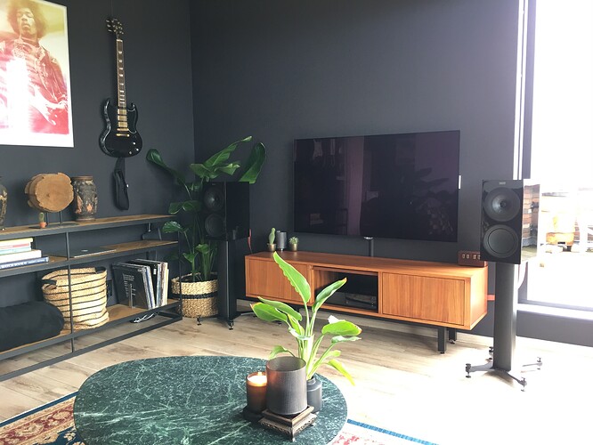

Since recently i replaced my KEF LS50 for the KEF R3 and because they’re bigger I needed bigger speaker stands. Paired with the Nova it’s a great system for the apartment i live in.
The stands are Dynaudio Stand 20 and have one large hollow column, witch can be filled with ‘something’.. Dynaudio provided a plasticbag with it so anything is possible.
So what is the best material to fill it with?
