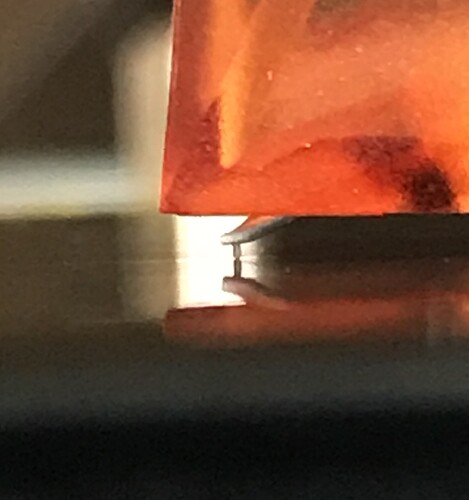

Suspension was the biggest factor for my 35+ year old Ortofon as the hours on it weren’t great. When i brought my turntable out of hibernation a few years ago the first play almost left the cartridge body riding on the surface of the record
as the suspension had degraded so badly. I didn’t sound too good either! And yes I did check the tracking weight. :0)
