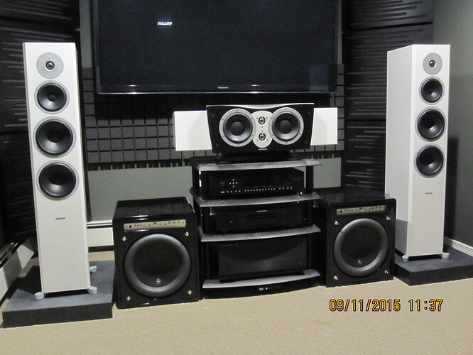

Or heavy granite slabs as in Noquarter picture. But personally I didn’t liked the sound of speakers direct on granite. A bit cold.

To be clear, in those photos I was just experimenting with the spikes directly on the granite. In the end I used the discs that came with the speakers,which are about 1 inch diameter,between the spikes and granite. They have a dimple in the middle and are .125" thick,a lot like Naim chips, but a little smaller.
So the granite formed a flat and solid platform on the (thin) carpet.
What were the discs made of, and how did they change the sound?
Yes the granite provides a solid flat base,very stable on carpet. I think the disks were made of brass,they came with the speakers. I did not do any serious AB testing with or without the disks,the Taksims are great speakers,very easy to drive with no crossovers in them. The only reason I got rid of them is I moved to an apartment,they are big,and I also have XD 600’s…

When i moved from a house to an apartment i combined a 2 channel room upstairs (photos i already posted) with my basement 7.2 home theater room. I still have 4 of the granite slabs, my XD’S also sat on slabs in the basement.
