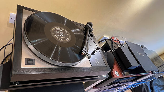

Wow… in a single word! Everything has been switched off for 24+hrs (and know the 250dr and 252 will definitely need time again to stabilise), but within 30 seconds of putting my first record on, it’s sounding bonkers! Yes, VERY noticeably better. I thought the Radikal 1 was great (and couldn’t understand how it could change that much for the better), but this blows it away. As great as it is/was, it never made things sound as real as this does. Literally can’t believe the difference in how believable voices sound and how much more texture and definition there is to every single instrument.
I’m going to stop now and let things warm up for a while, but wanted to let you know Peter @Cymbiosis. Wowsers, I’m in for a great weekend! :blush:
Thanks again for fitting me in so quickly and recommending the perfect upgrades!
Keep us posted with the iterative improvements as all bed down/warm up again.
Yeah, I’ve just given it another hour just now… yeah, it’s laughably better. Sounds like a system that’s twice the size it was. I’m not sure which change is which part, but they definitely make a heck of a difference. The best way of explaining it, is ‘real’ and natural. It sounds less forced and just sounds much more organic and natural. Instruments are much easier to define in each song and they have more 3d feel to them, rather than just the sound. The sound has space and feels more tangible than before, so more like listening to real people/bands. Bass is definitely deeper, more solid and punchy, but loads more tuneful.
Needless to say, I’m very happy with the sound benefits that they’ve brought. You were absolutely right in your prediction @Loki!!
So, I did think that the stageline was holding back the scale, but a power supply upgrade and better subchassis say otherwise! :blush:
So pleased for you!. Been there and still wearing the chain mail with a rather stylish cloak!
Haha, yeah… I’m absolutely chuffed to bits with it! I’d say it’s a bigger change than getting the radikal 1 if I’m honest and that was great at the time, too. Seems to have made everything click.
